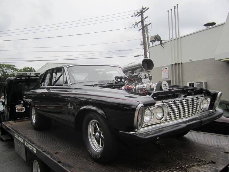

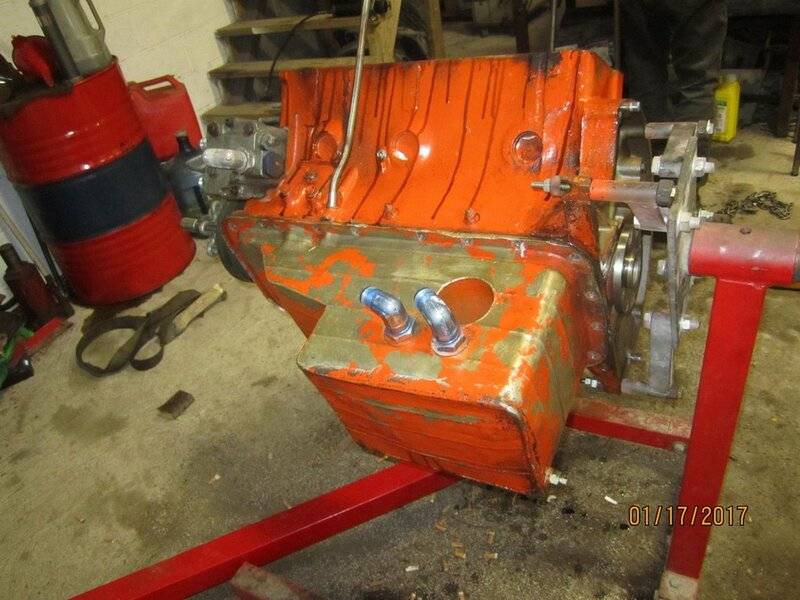

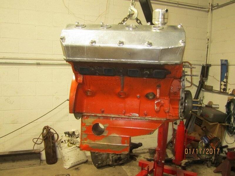

When I 1st dropped in the big block with the milodon oil pan,I had to raise the engine so the centerlink would not touch the front of the cross tube in the oil pan.I ran it that way for almost 20 years. Fast forward,now I have a Racepak and I'm seeing lean at the hit with the event lasting almost a second.More on this later.

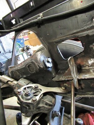

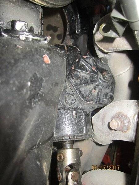

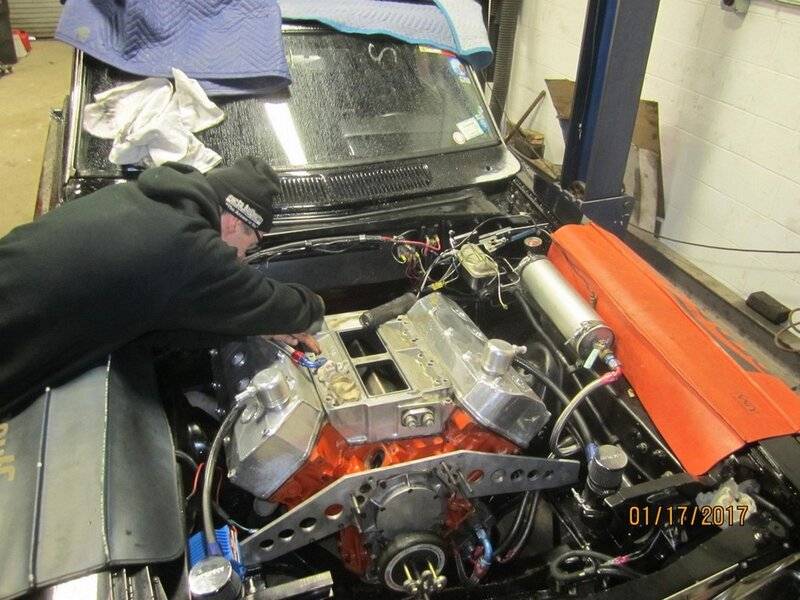

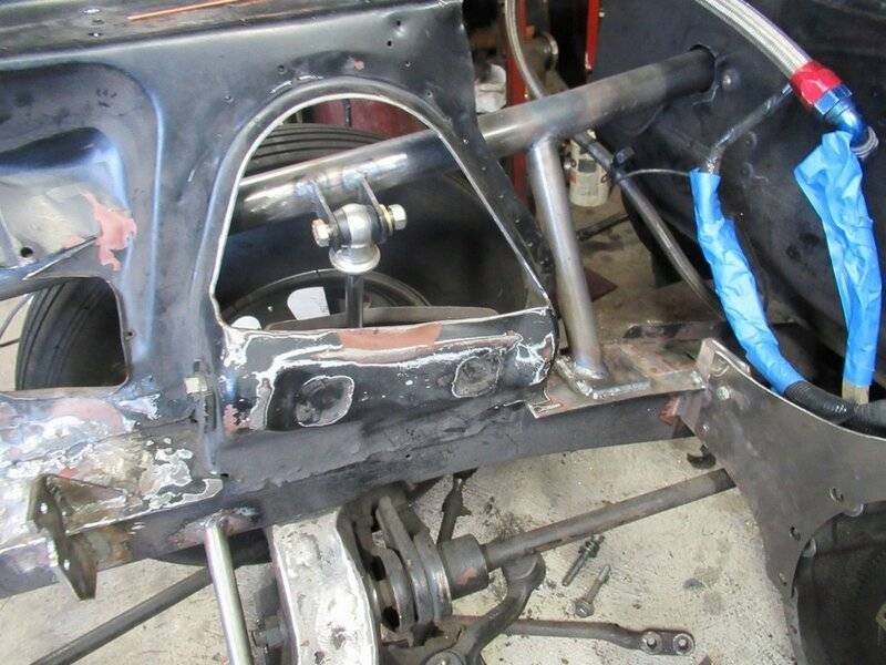

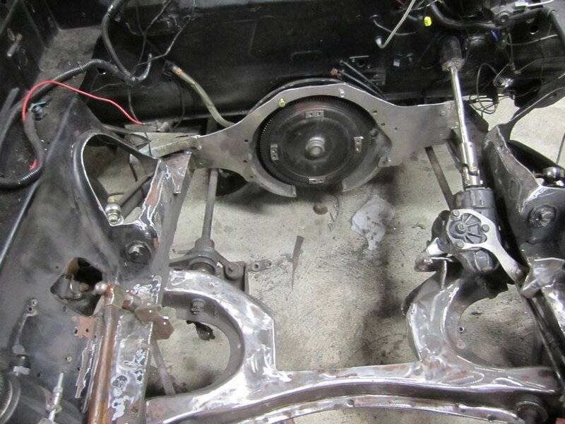

A few years ago my good friend was to help me freshen my engine,so I brought the car over to yank the hemi out. Told him of my intentions to bring the car to s chassis shop to install "J" bars.Leo said why bring the car there,,,,I can do zeees.
After much conversation,sitting around the car with a bottle of 1800,Leo came up with the battle plan after measuring everything up.I had raised the front of the engine up to 8* nose up years back for clearance.This caused the fuel to uncover 4 jets effecting the leave and 60ft. Funny part,I had to leave to work sometimes a few hours at a time. One day I come back to the shop and he moved the engine down to 1* nose up and set back a little over 2 inches!!!
1.17.17 002.jpg 1.17.17 003.jpg 1.17.17 004.jpg 1.17.17 011.jpg 1.18.17 003.jpg 1.18.17 009.jpg 2.5.17 003.JPG 2.19.17 032.jpg 2.25.17 012.jpg

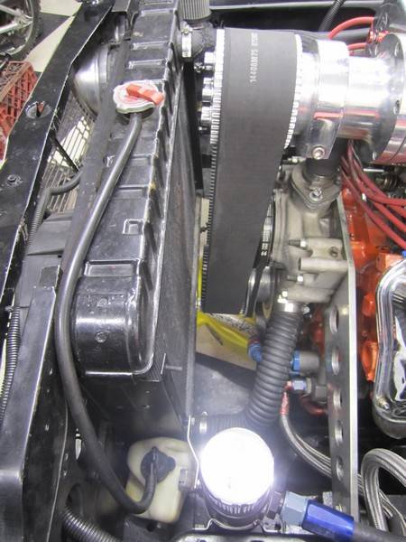

Before the engine setback there was one inch of room between the bottom blower pulley and the radiator.No room for puller fan or fans,they had to be mounted between the rad support and grille............................Pushers.

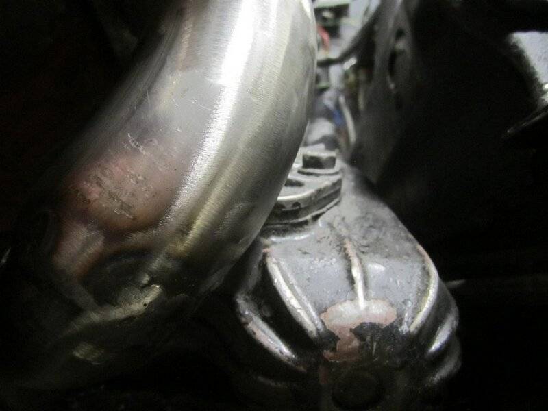

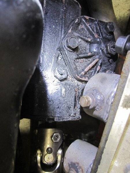

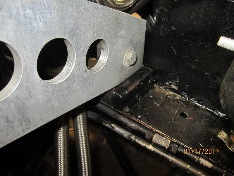

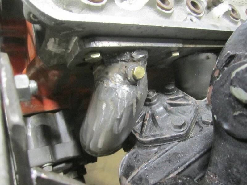

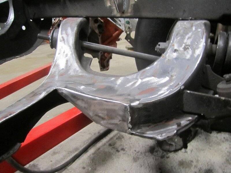

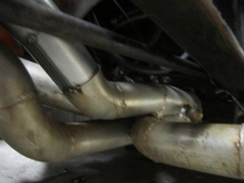

You can see from the pictures how lowering the engine to 1* nose up took the spacer out from under the engine plate and then notched the engine plate.Hard to show the engine set back but had to REdo a few header tubes!
5.19.12 012.jpg 8.1.14 020.jpg 8.18.13 078.jpg 4.27.17 003.jpg 4.27.17 005.jpg 5.9.17 034.jpg 5.9.17 036.jpg 3.23.17 021.jpg 4.11.17 008.jpg 4.24.17 009.jpg

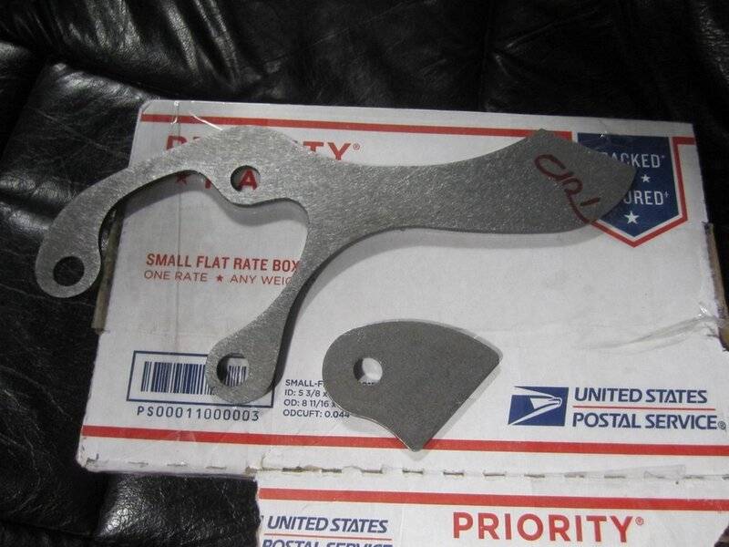

You can still do a "J" bar in the front.I did mine in the wheel well.You can weld to the firewall and tag the shock towers.I removed my shock towers for elephant clearance.

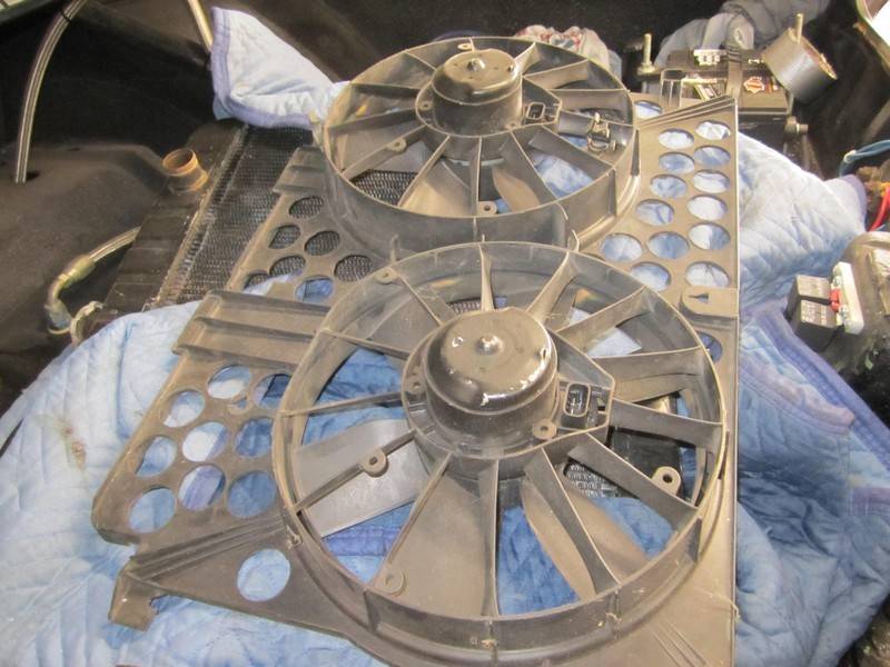

On my 64' Polara I cut the core support form inner frame to inner frame ,about 30" wide and reusing the top section of the original core support and a new lower cross brace from us car tool i rebuilt the core support. The corners are 1 1/2" x 3/16" angle with 15"x 3 1/2" pieces of 16 gauge on both sides. The lower cross brace was dropped 3/4" to let the radiator go down the same amount. This was done because now the radiator cap wants to sit right under the hood brace and needs the extra height. I'm still using the stock hood latch set up as it clears everything... barely. This was all done because i switched to a cold case 26" radiator with dual Derale fans and a CVF Wraptor serpinetine belt set up that eats up even more room. By the time i was done cutting up the stock core support there wouldn't have been much left of it. Not sure about other b bodies but on a 64 Polara the radiator sits higher than the core support so you can't just sink the radiator into it by "picture frame" cutting the support. I oped to use a RMS Alterkation front end and didn't want to mess with the engine mount location not knowing what other problems pushing the engine back would cause, Headers, rack & pinion, trans tunnel e.c.t.
