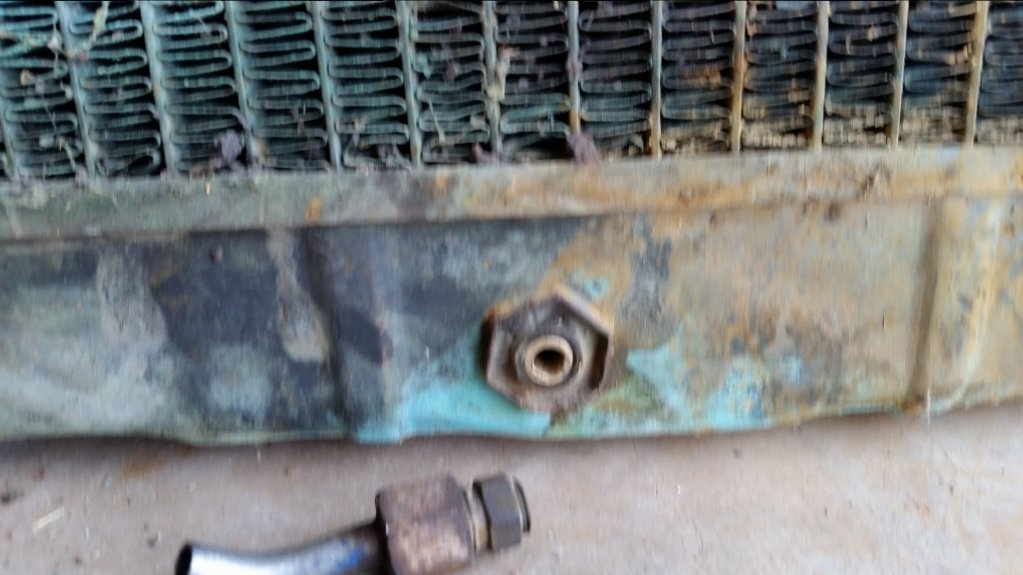

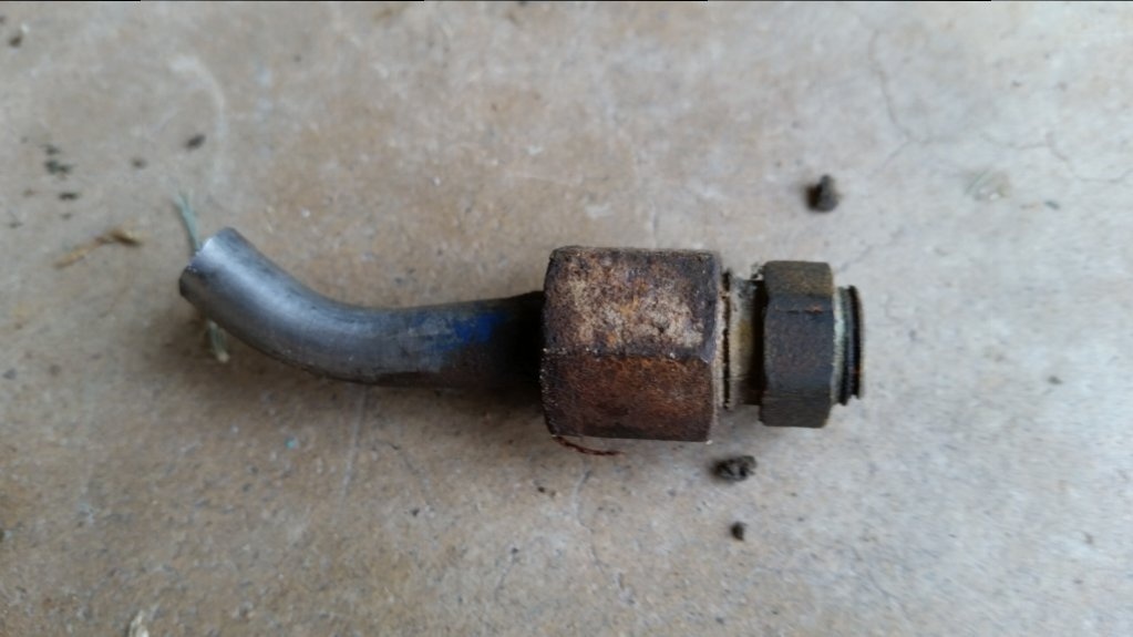

It broke at the radiator. How can i get the piece out of the radiator?

Easy out. If you don't have one you MIGHT be able to tap a screw driver inside and twist it out.
They look kind of like a drill bit. It just swirls the opposite direction. You should be able to find them at most hardware or parts stores. What you would do is sit it over the hole and tap it in with a hammer til its firmly inside then use a wrench or vise grip it should come out with the rest of the fitting stuck to the bit. You may wanna spray some wd40 or penetrating oil to loosen it up a little while before you try to remove it.
