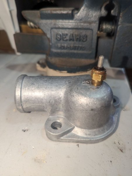

I have the Slant Six with a standard looking water outlet containing the thermostat. I drilled and tapped a hole into the water outlet for my second sensor. The water outlet had room for the sensor to stick in there. Now I have the dashboard temp gauge in the head before the thermostat and the after market temp gauge in the water outlet after the thermostat. I can physically see when the thermostat opens with this arrangement.
