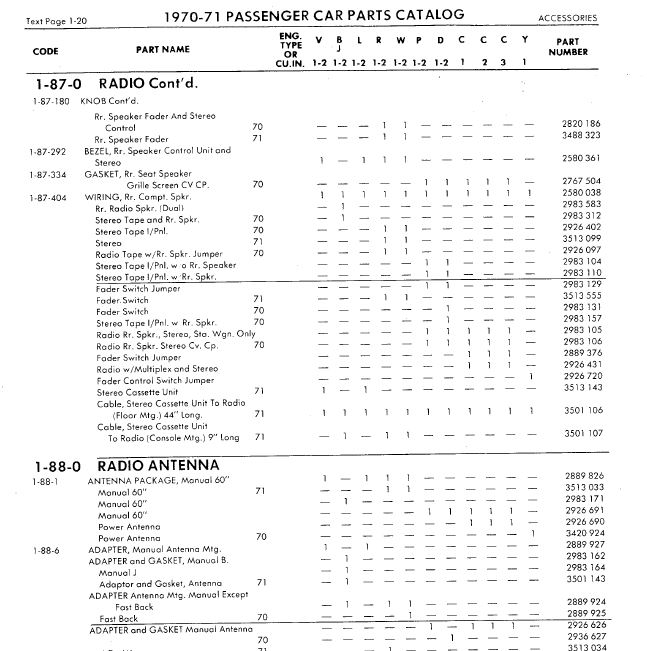

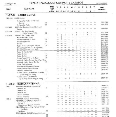

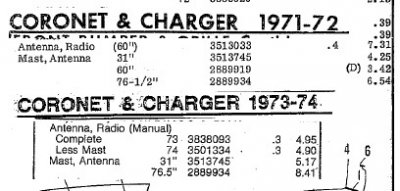

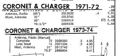

Well, I put this together from the collision manuals. Easier to show you than explain I guess. Also let me say this, I had a brand new 73 Charger and my Dad had a brand new Monaco back in the day ... they BOTH came with AM/FM and the 31 inch mast.
Having said that here is what the manual shows:
Im assuming the 31''inch mast on your cars were the fixed style??? If I read it correctly your repair manual shows three different lengths and four different part numbers. and again it appears (my Guess) to me that the short 31'' would be fixed and the talls would be the telescoping. Now, what radio takes what mast? AM takes telescoping and AM/FM fixed??????

The antenna was the same for AM and AM/FM cars.antenna.JPG
