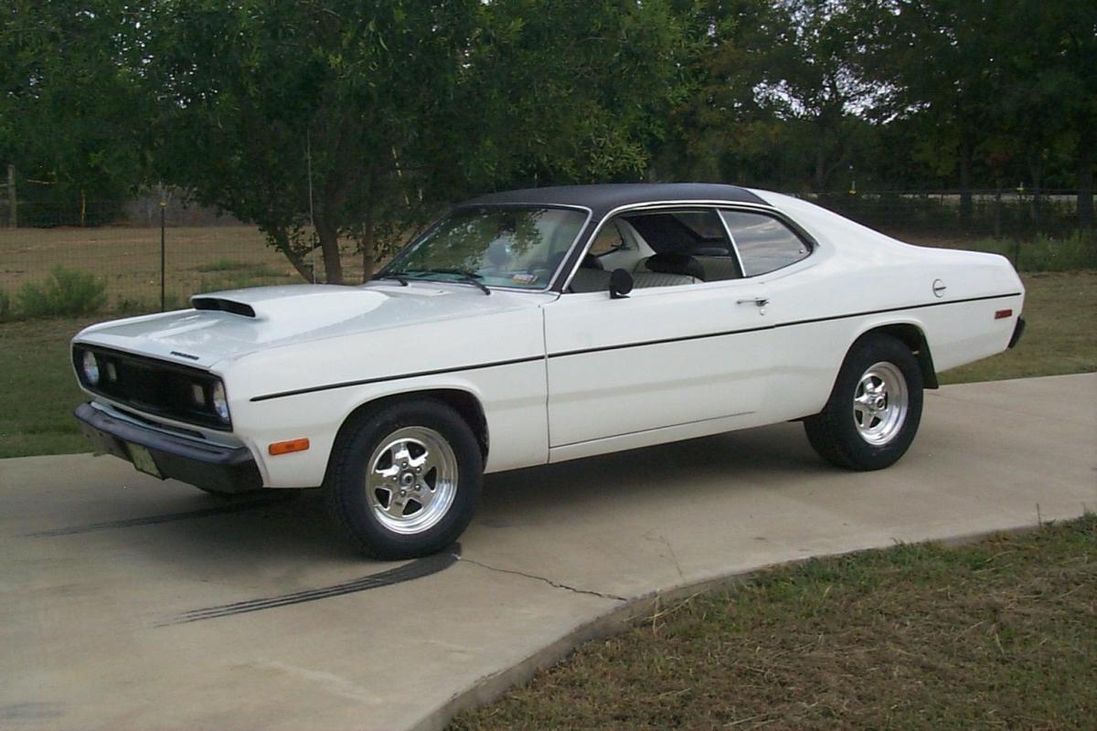

Here's a before and after on my Duster. Before had the /6 springs and (gulp) air shocks (courtesy a P.O) and the after is XHD's and Monroe shocks. Rides better too
Damn;nice Duster there,Runner! Perfect stance for those cars too. That's where I want the S.F. to sit;just slightly nose down.
Hey;looks like some hooligan did one of them "burnout" things in your driveway:yes:. Damn neighbor kids:tongueflap:! Juvenile delinquents everywhere,I tell ya!

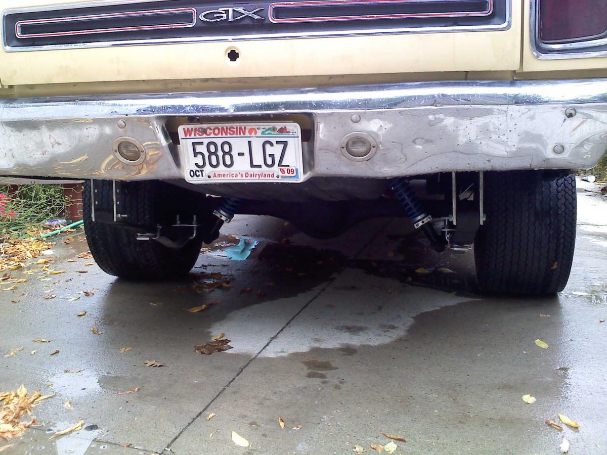

wannadrag at autozone there are universal lift kits and verious items that can assist in stiffening up your rear. i have found and bought a universal coilover kit that fits on any shock for $30 supposed to add up to 1500 lbs of extra support also for around 30 they have leaf spring helper springs that bolt on to your leaf springs to add more support. my springs were shot to start with under the cars own weight with no one in it they had almost no arc almost flat i wanted alot more hieght to put my n50's under her so i bought the drop shackles and that wasnt enough so i went and bought the leaf spring helpers wich actually gave me around 2" less sag on my worn out springs but still not enough so i bought the coil over kit at first sat high enough but big bumps still had tires rub fender so i preloaded the coil over kit and now it sits well and can take bumps. now i wound up getting a very nice tax return so i decided to buy new leaf springs from summit but havent installed them yet they were around 225 or so shipped. caution with the idea of new springs they had ones that are heavier but those springs if you read all the print say they require new (moved) front mounting brackets. odds are the ones under your car are from 70 so just getting the stock replacement ones should be stiffer than the 40+ year old ones. any way im running on here so also heres a pic of my rear with the shot springs longer shackles, leaf spring helpers and the coil over kit. sorry its not a close up shot
