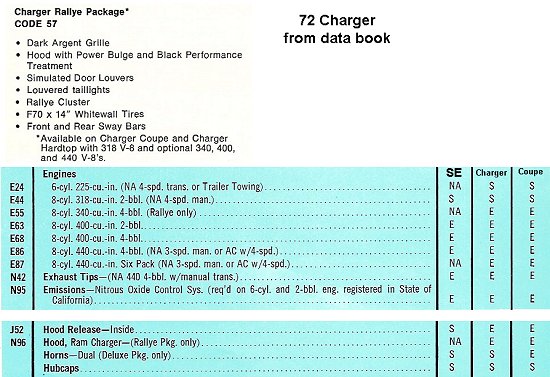

I'm going to look at a 72 Charger this weekend.
The seller claims it's a real Rallye car, but I doubt it.
It does have Rallye doors, but no hood or taillights.
It is a 400-2 car, which I'm pretty sure WAS available in a Rallye.
(Which would eliminate machine gun tips, right?)
I know I'm looking for an "A57" on the fender tag, but...
Let's just say it IS a Rallye car AND happens to be a Lynch Road car...
1st- did they build them there?
2nd- would it still have the A57 code?
3rd, regardless of assembly plant, would all Rallye Chargers have a rear sway bar?
I may be interested even if it's not a real rallye car, just want to be well armed, and value consious.
*Bonus question- It's a big block, and it's a Charger. Is it a muscle car?
*Has buckets and SlapStik, too.
*It's also got high impact paint- EV2 Hemi Orange. How about now?
1st- did they build them there? Yes
2nd- would it still have the A57 code? No. LR did not code that. Look at other items on the car. See list below. Ask about the broadcast sheet to confirm A57
3rd, regardless of assembly plant, would all Rallye Chargers have a rear sway bar?Yes
*Bonus question- It's a big block, and it's a Charger. Is it a muscle car?Maybe....
*It's also got high impact paint- EV2 Hemi Oramnge. How about now?closer...:) good luck

Lynch Road plant didn't show A57 on tag as said above, but "sometimes" they did cut 1 or 2 of the codes for the individual Rallye package items, like M08 for simulated door louvers, V21 for performance hood treatment or V22 for delete hood treatment(paint). If the 400 2bbl is factory, E63 will be on tag and would have had single exhaust and no cutouts on rear pan, but would have the rear anti-sway bar.

Check the number on the car, to the number on the fender tag. My rallye has front and rear sway bars and that is about all i know. Does the guy have the build sheet?

Went to see it. Nice paint. No sway bar, no rallye dash. Rallye doors were just stickers. Decent interior.
