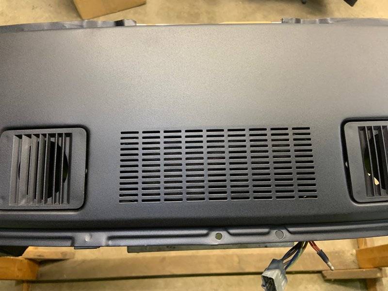

Converting the dash frame isn’t the way to go. as others have said, get yourself a rally dash frame, then your gauge cluster, wiring harness, trim bezels, and dashpads. This is what I did, and the only piece I reused from my old dash was the upper dash pad.
