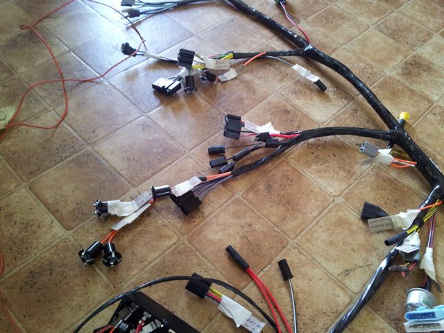

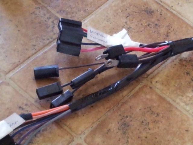

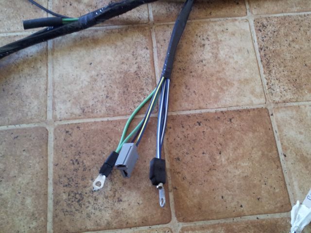

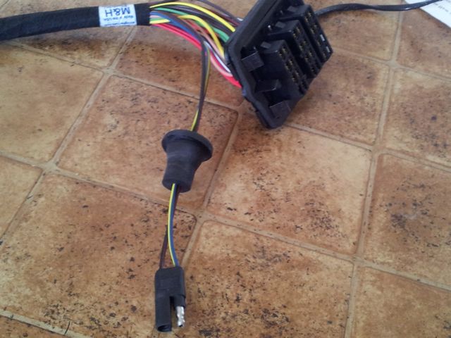

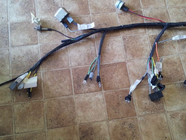

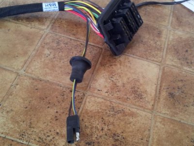

Hi all. I recently purchased a new dash harness for my 70 gtx. It's got a couple of extra bits that the old one doesn't have. I've taken some photo's and hope that someone knows what they are. The two wires with the grommet near the firewall block, blue/yellow and black/red, and the one with the grey plug and the two doubles, dbl green and dbl blue with white tracer. The one with the grey plug has the same colours as the one with the grommet so I assume they're linked. Any ideas anyone? Please disregard the bottom photo's, I can't work out how to delete them. :icon_biggrin:

I've checked my manual diagrams, and I can't see what those wires with the loop end lugs are for. They don't look like anything in my GTX. Only thing that I can think is maybe a circuit breaker - but it could be for power windows, or convertible top (which you obviously don't have). Can you trace the Blue* and Green pairs to either end - ie/ fuse block? to bulkhead connector?
The red/Black and blue/yellow on the grommet maybe for hood amounted turn signals, but the colours are wrong. Did you actually get the correct harness? It almost looks like a mistake was made with some wires there. I did have a spare set of front turn signal wires in my new Front-end lighting loom, but they are easily hidden, and not an issue - same colours as you are showing too.
Hi Kiwi. As far as I can tell I got the correct one, everything else lines up with the old harness. I haven't tried to trace them yet against the diagrams I've got, was afraid of going crosseyed. Hoping that someone here would know.
Since the harness is new, it shouldn't be too difficult to trace out the wires with a meter. Hopefully at the fuse-block end you can see the circuit name to get a clue. Also at the bulkhead end we should get a clue - give us the terminal letter marking (A-Z), and it should shed some light. Only other think I thought of was after looking through your gallery pics, your car is A/C, so maybe it's something to do with that?
Dbl blue traces back to N position on bulkhead. Also connects to park brake light. The dbl green is connected to the lights somehow. The blue/yellow are connected either end but there must be a break in the other one as I can't seem to connect it with anything.
Position N on the bulkhead feeds the "Number 1 splice" - which goes to the Voltage regulator, Alternator Field, and Ballast resistor. That tells me that it connects inside the dash area to either the steering column loom, and/or Emergency Brake warning light, and maybe even the power to the Tachometer if so equipped. Definitely different to my loom which is original.
The Blue/yellow may be part of the headlamp delay/headlamps ON circuit, which requires a plug-in module/relay that your car may not be equipped with.
Sometimes these aftermarket looms throw up a different colour and it does get confusing.

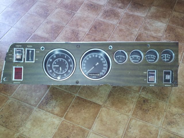

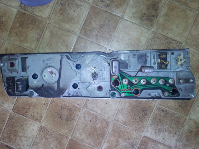

Can you show us a picture of the dash rear - gauge layout etc?
thanks
thanks

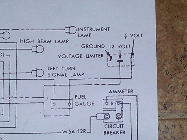

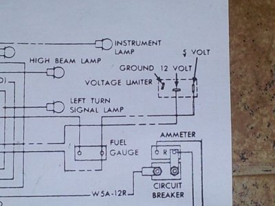

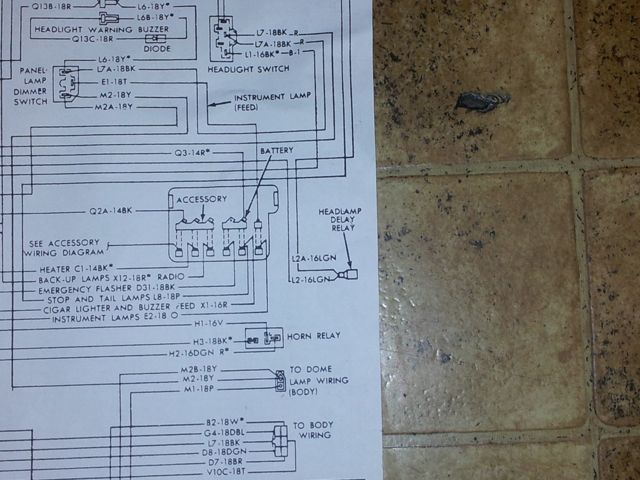

Since my original didn't have these I'm assuming that it didn't come equipped as you say. I've also added a wiring diagram which shows 2 green going into a headlamp delay relay, and the blue going into a voltage limiter. I really don't know how to read these things properly so I'm not sure how it applies.
You have a 70 Charger harness for the dash. Those extra wires are all for the headlights, ie electric motor. There are those people that sell "70 B Body" harnesses & say they`re all the same, but they`re not. :icon_frown: I`m not sure if you can use this & let the plugs lay unattached but, I would start with whoever sold this to you & tell them you want a "70 B Body harness, excluding Charger".

Yep I believe 6pack is right. Even being a '69, my Charger has a similar extra grommeted plug through the firewall that connects to my headlight harness. In my case I want to say it's for hood mounted turn signals but I could be wrong.
Just a bit of further info for those interested. I rang M & H who make the harness and they confirmed that the extra wires apply to the Charger. They use the same harness for both Charger and non Charger. They said if I just heat shrink over the extra connections to isolate them the harness will be fine. Thank you to those that helped out. Cheers. :VB toast:
