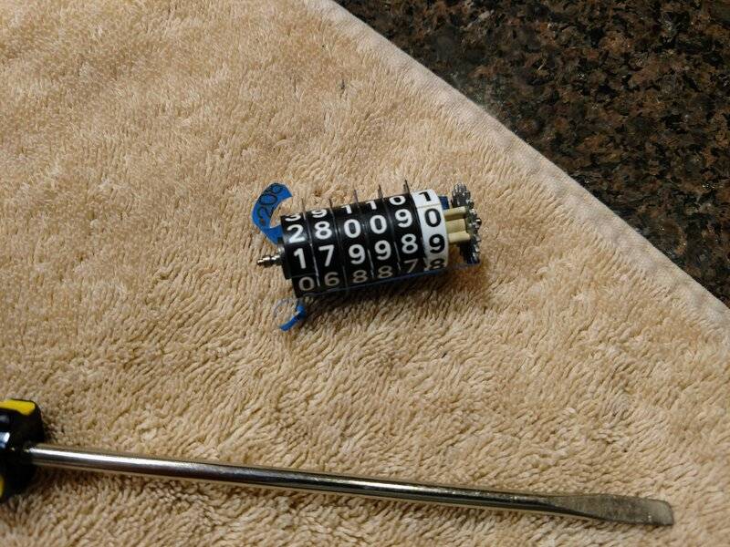

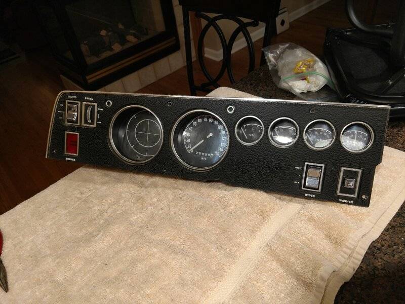

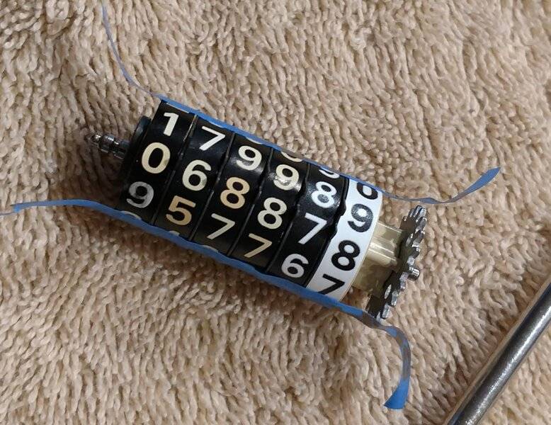

There is a series of shorts videos on YouTube, by Mr. Heaterbox. It focuses on E-body gauge refacing, etc., but the rules are the same for B-bodies - this is what I referred to when I did my rallye gauges on my bird a couple years ago. Here's one on the speedo:
The pictures show the tumbler assembly removed, then refaced, then the total assembly using some of these videos. It's really very simple. Take your time.

View attachment 1123632 View attachment 1123633 View attachment 1123635
Ah thank you sir!!!
