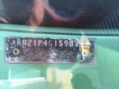

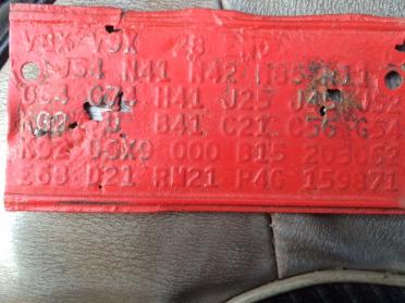

car 2.jpgcar.jpgI'm assuming someone did change dash heres the vin# definitely a RR also have the fender tag
im not too familiar with the 71-74 bodies, but it seems to me that that VIN plate looks a bit odd...

Yes they check out I'm 100% she's a Real RR, I was just questioning the dash, at some point someone must have changed out the dash for whatever reason

All 74 Road Runners should have come with a rallye dash. That being said - Maybe the rallye cluster failed at some point and the previous owner installed a standard cluster. Might be some wiring issues with that but could be done.
Problem with these cars is that the VIN tag is attached to the dash assembly - and the whole dash assembly can be removed from one vehicle and placed in another. You said you have verified the body stampings on your car? If the stampings on the radiator support and the upper cowl match your VIN - then you should be good to go.
