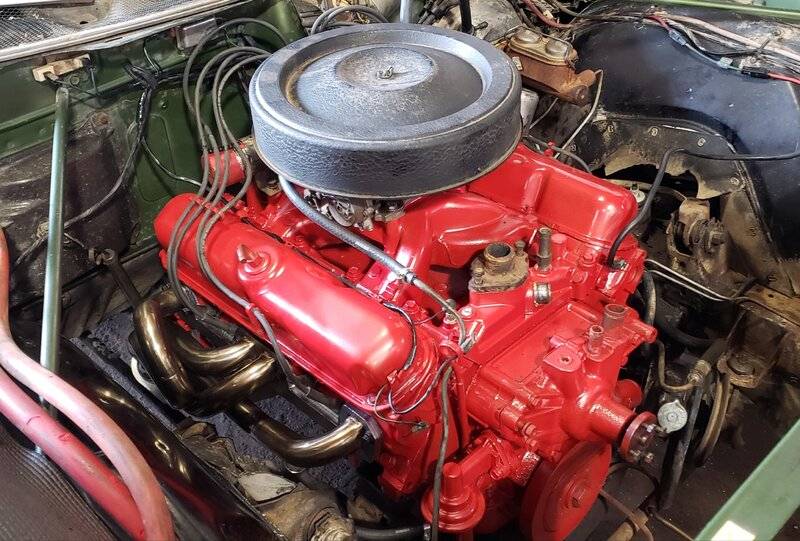

I did this swap in my 318 69 Polara wagon. Replaced it with a 5.2 Magnum and dressed it with LA parts and cheap Ram/Dakota/Durango shorty headers. Car is noticeably quicker and more fun.

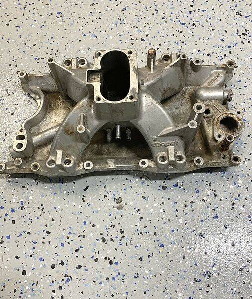

When I had my Dakota RT I used a Mopar Performance M1 intake for the magnum engine.. It was very expensive and now elusive. But it still used the throttle body. Mancini had it for under 500.00 They had a 4bbl version too.
Wow this guy on ebay is smoking crack... 1499.00 for this nasty *** intake.
That thing actually makes great power.

Did this in my 73 Challenger...
Swapped the following.
-Oil pan / pickup
-Timing cover to "LA" style and used factory V-belt pulleys and water pump
-Added camshaft snout for mechanical pump
-Dual pattern intake manifold for LA or magnum heads
-I kept the A-518 trans but if you went to a 727 or 4-speed keep in mind the external balance of the magnum engines is different than the old 360s
