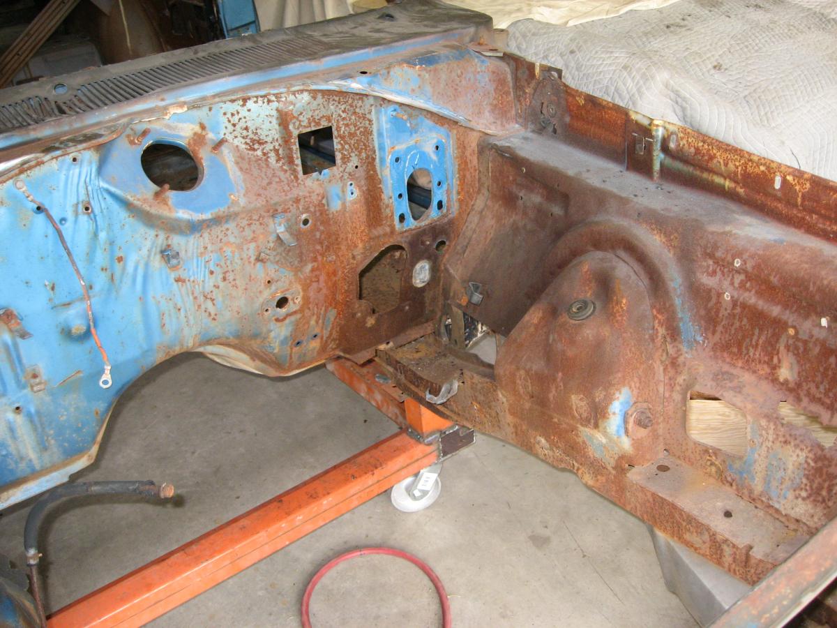

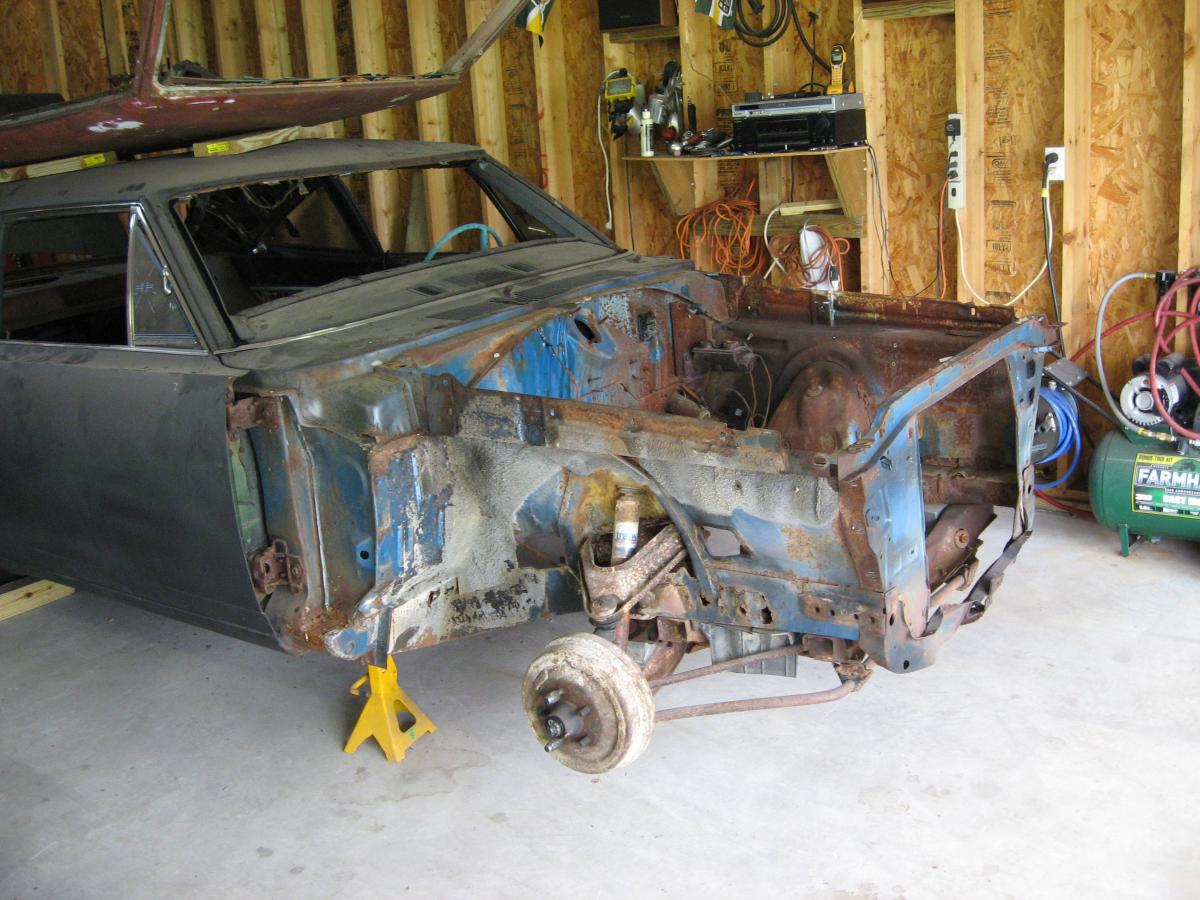

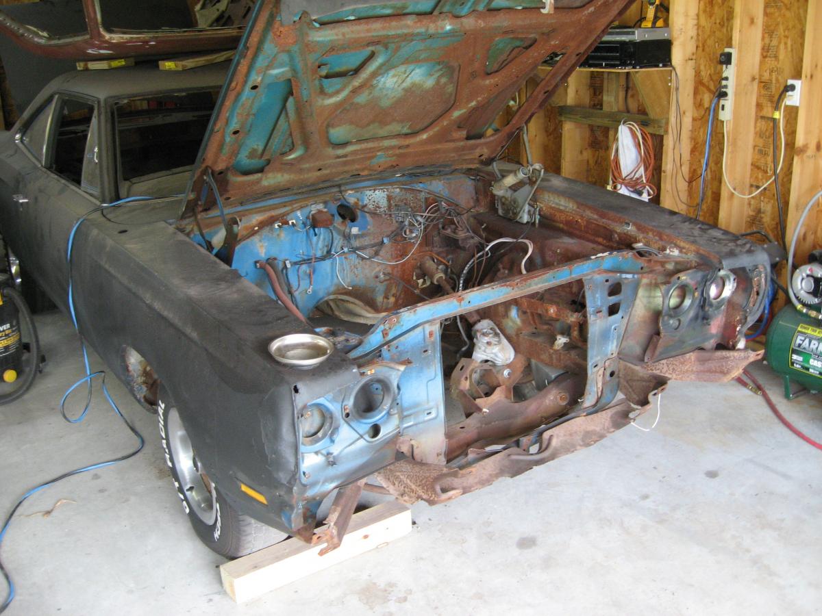

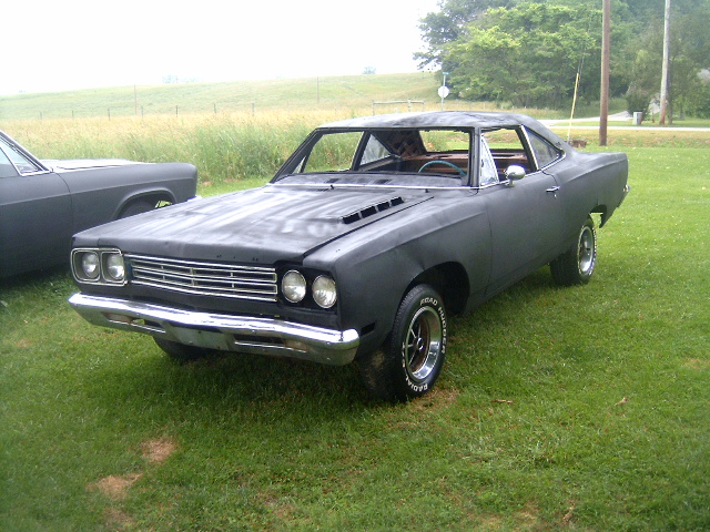

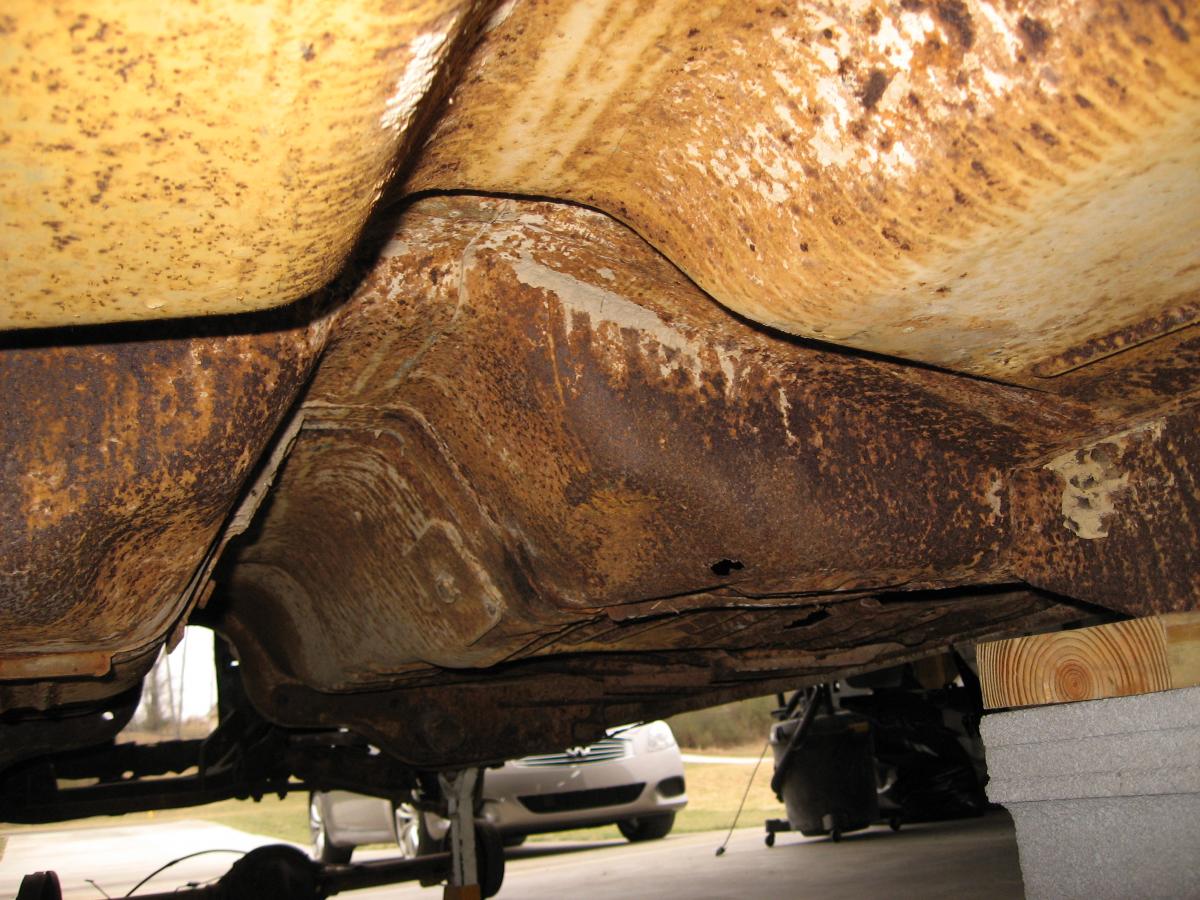

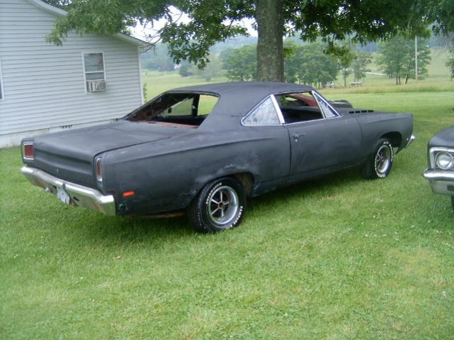

I have been here for a while and told my story to some, but I want to start this thread to keep you updated on the progress. To start, I bought this car in TN in hopes to save it from the crusher. I have seen cars in better shape and the style is nothing special (69 RR post car, 383 column auto, blue), but I wanted a challenge and I sure got it.
So here are a series of pictures that show some level of the "deconstruction" progress. Enjoy!!
Randy

Got it on craigslist out of Cookville, TN back June 2008.
Yeah, Donny, I have been checking your stuff. All good. I found a NOS front clip that is at the blaster today. Perfect cowl,
When I get it back I will add pics. I plan on swapping the everything in front of the firewall including the frame rails.

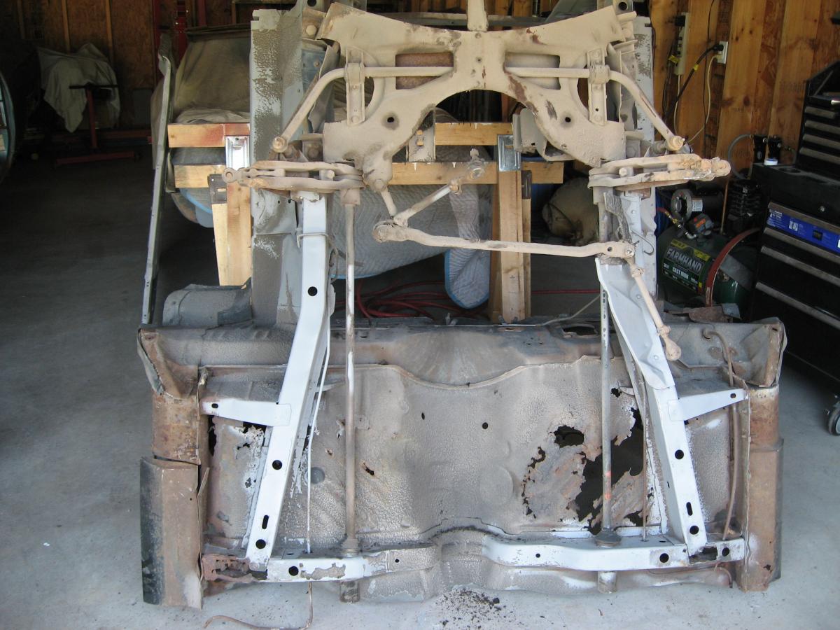

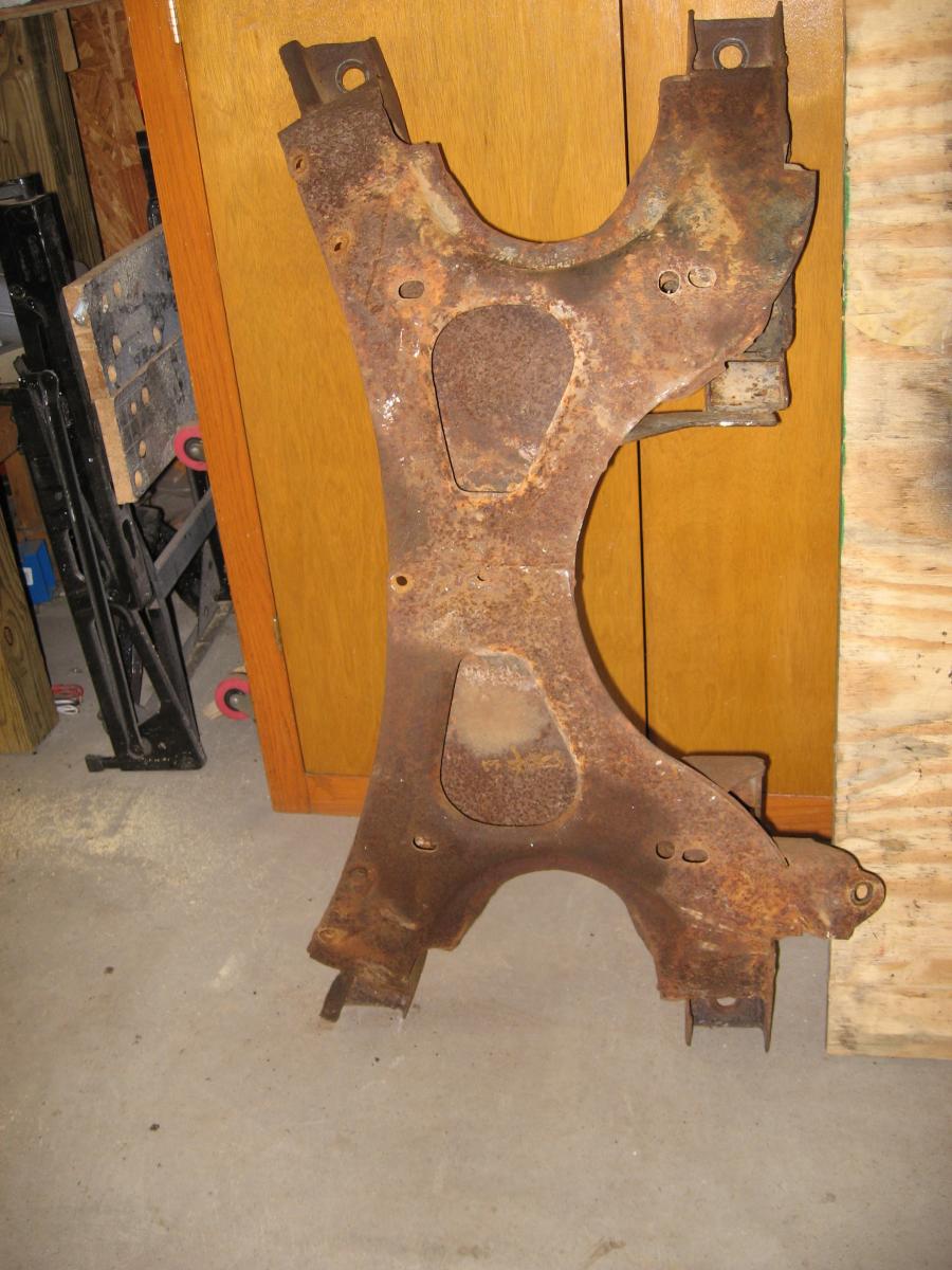

Got the clip last night. pics attached. Crossmember is probably not salvageable. I may need to buy that new. The rest looks great, radiator support, inner liners, frame rails all are sweet.

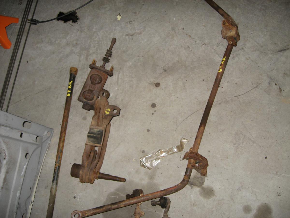

whats the clip off of, that swaybar dosent look like a b-body unless they had 2 different kinds,unless its I not usually looking at the k-frame from that angle

Its a 68 4-door belvedere with the 6 (cheap-cheap). So the k-frame is funky. If you know anyone who wants it or the torsion rods, send me a PM. Otherwise, I get $10 per 1000lb of auto steel.

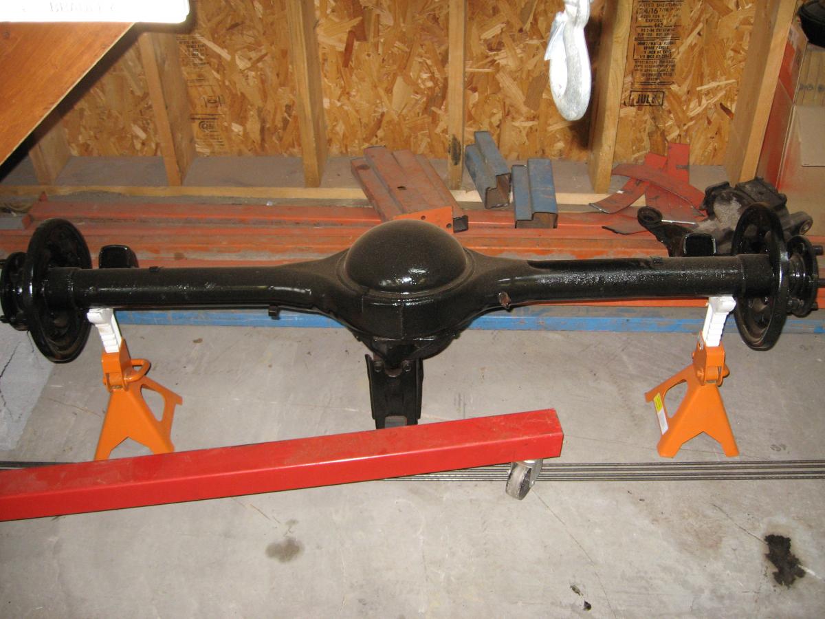

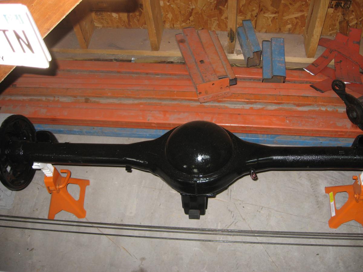

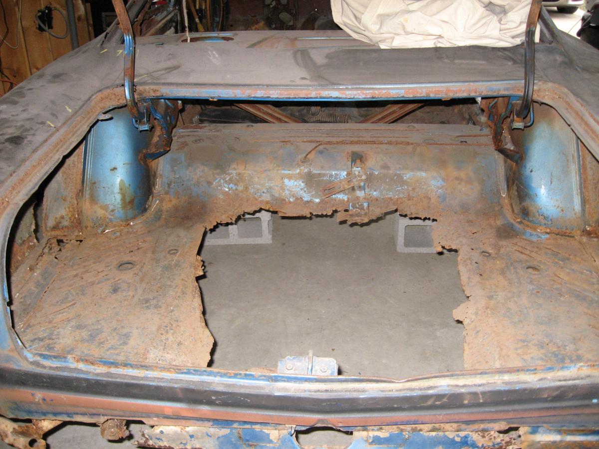

K-frame is off and I am preparing to remove welds. Also, rear is rust converted and ready for prime.
I have the fender tag if it is of any use. The VIN plate stayed with the salvage location as is required by law.

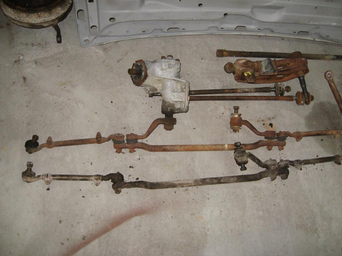

Existing k-frame removal was a BEAR, one stupid torsion rod was stuck in the frame and the k-frame bolts were rust-bonded to the frame rails.

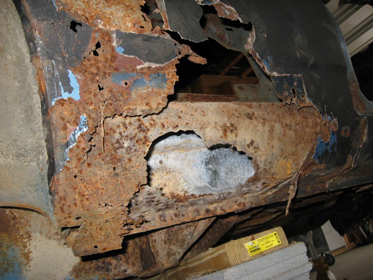

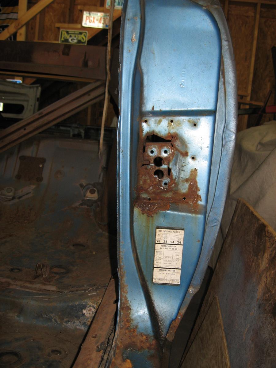

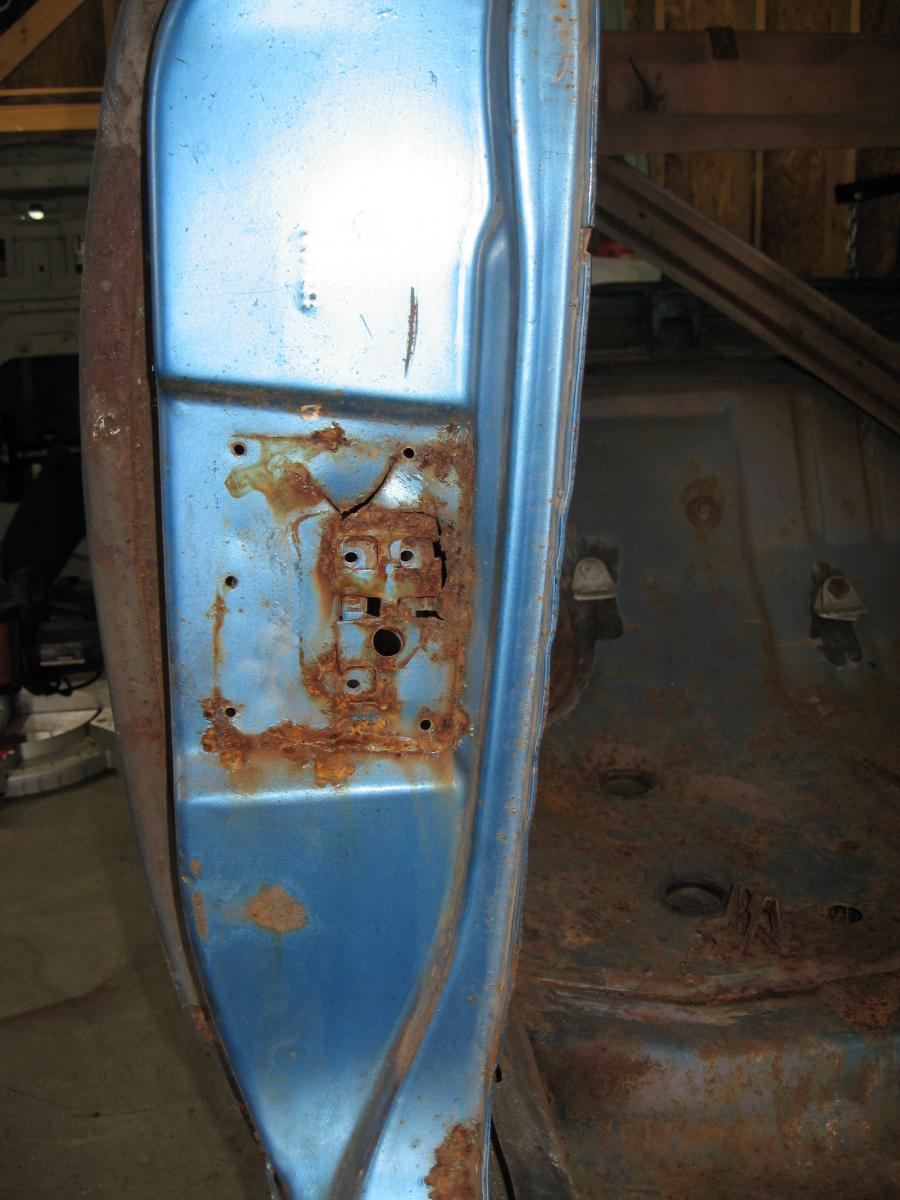

I cut away most of the rusted issues and completed the dis-assembly of the K-frame. I found the swaybar was bent pretty badly (looks like an accident), so that will need to be replaced, and the door latches were cobbled in so I will have to source a door frame to steal the latch mount. I finished painting the rear, its a bit glossier than I wanted, but it will be fine. More pics:

Quite the project Randy; brings back a lot of memories for me. In the '90's I went through a '70 Coronet that was hit hard on the drivers side front; drove the frame rail back, even the trans crossmember was pushed a bit. I replaced the complete front unibody structure on it; radiator wall, inner fenders, frame rails, trans crossmember. I left the donor section in one piece ( the box section like you have pictured ) which made the swap a lot easier. Keeping it as one unit keeps everything square, less chance of altering the diminsions of the chassis. Good luck with it!

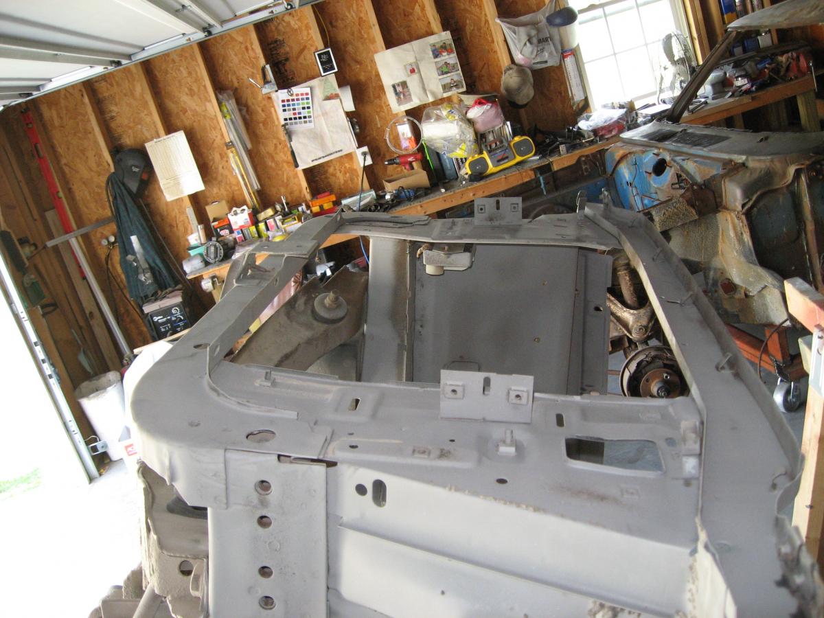

Thanks, definitely keeping the box section in one piece. If the cross member was salvageable it would be even better. To help keep the box square I am going to install the k-frame on it. Right now, i am building a fixture to align the assembly in all three dimensions, and that is going to take some time.
