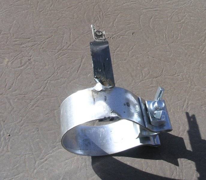

Rattle can shaker tool I made

Reciprocating saw blade and muffler clamp. Works great. Don't know if I had to, but I used a propane torch to take the blue out of the blade.
I just use a large worm drive radiator hose clamp and a long rough in blade. Been using the same blade for years now.

Interesting idea.
At first I thought that it looked like a solution for a problem that doesn’t exist.
Then I thought of how some people might have sore joints that get worse when trying to shake these cans long enough to get the paint to mix and glow evenly.
Good for you for sharing this.

I was just needing such a device! Where was this post two days ago?
