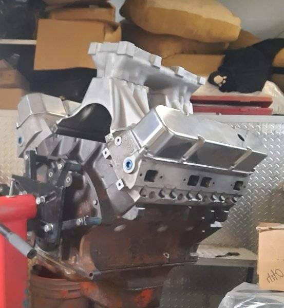

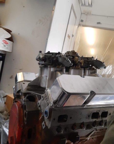

After seeing this pic it would seem they could be safely milled
Milling would be easy enough. Lining the actual intake face to the head face would be easy enough. But the ports are probably in a different location downtream from the original intake flange. They could be lower, openings spread apart further apart from each other, different shape and dimension, bolt holes may not line up. That's where the real work lies. Proably easier to modify the Mod Man. We have done that on a 486" low deck. So far the intial testing is showing some promise. 9.7x@136, 3585lbs
