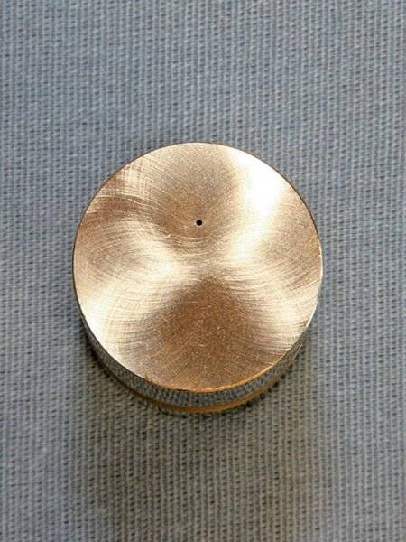

Can you send me a picture of them??

[1] Hole in the base only works for solid lifters....
