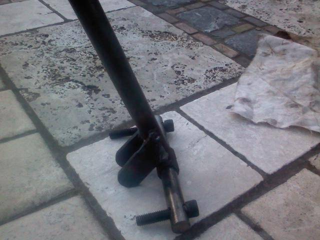

Thanks but I got very impatient and made a duplicate copy of one from pics on the internet I will be installing my valve springs tomorrow this is after I spent 40 on a universal one on ebay that will not work
Be careful, it appears on yours that the pieces that contact the spring retainer are fixed, that may "cock" the the spring as you depress it. My KD tool has hooks that go under the shaft and the parts that contact the retainer pivot as it goes through the arc. BTW great innovation making your own.
