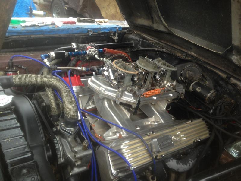

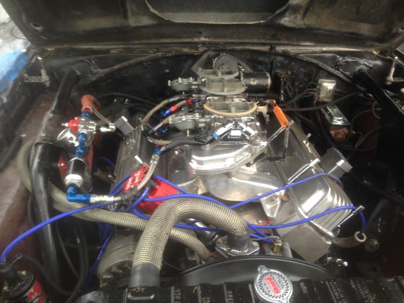

What do you mean any ideas on break in? sounds like you just got it broke in lol. All I would advise is change the oil and filter after a few hundred miles. just to be safe. This a stock motor? Got pics?
run break in oil (the oil thats in it for about 500 miles to seat the rings then chage oil make sure the oil has zddp . just make sure the timing isnt retarded air fuel isnt too lean . when broken in make adjustments , this is what i do.
520 stroker: eagle crank and rods, mahle flat top pistons, 11:1 compression, comp cam drag cam, 4 speed A833 rebuilt, 4:10 rear end, MSD ignition 6 AL, MSD vibration blaster coil, MSD pro billet distributor, external oiler(going to adjust to 60 psi at 2500 rpm) Holley whisper quiet electric fuel pump, with QFT bypass regulator, Edelbrock RPM heads, weiand super stock intake with Holley 6 pack rebuilt by Promax and dynoed at their shop($175 well worth the money) inner panels are made out of kevlar/carbon fiber, kevlar and 2 layers of carbon fiber, hose candy water fittings and vacuum lines ( quick disconnect), bypass line was ran with SS teflon, I will convert all my lines to this; teflon SS is easy to make.
