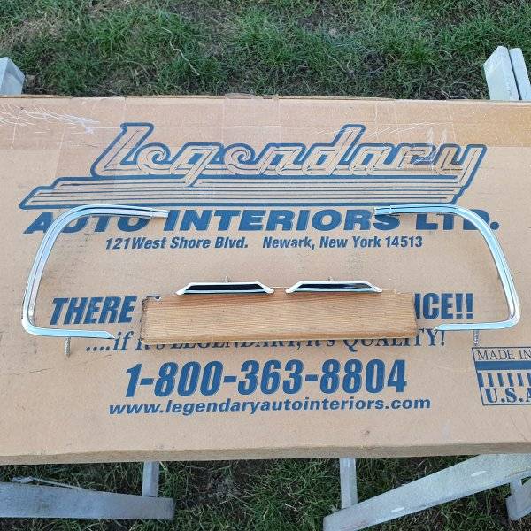

Hi,
i can do it my self and I would do all of your pieces but the shipping will be expensive…
I did almost every chrome part on my dads charger.
Here is the tail light trim for example.
Greetings from Germany
