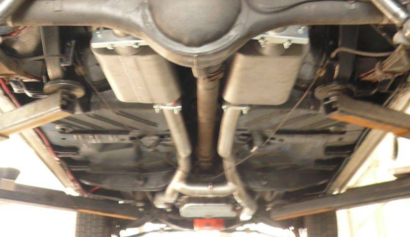

I have my 65 up and running now and I was wondering what you guys running a tti exhaust system did with your emergency brake cables? In the tti exhaust install directions all it says is that you will need to re-route your e brake cable when using an x-pipe tti system. Has anyone using tti changed up the e brake cables? Not sure what to do with mine. Any help is greatly appreciated. Would love a photo! Thanks guys!
i have a 3" h-pipe system on my '65 coronet. the cable behind the crossmember that ties the rear brakes together rubs the exhaust pipes but doesn't seem to be a problem. i did use a 1/4" eye bolt to pull the passenger side of the cable closer to the frame rail to prevent it from rubbing on the muffler. other than that no issues.
Same here!
