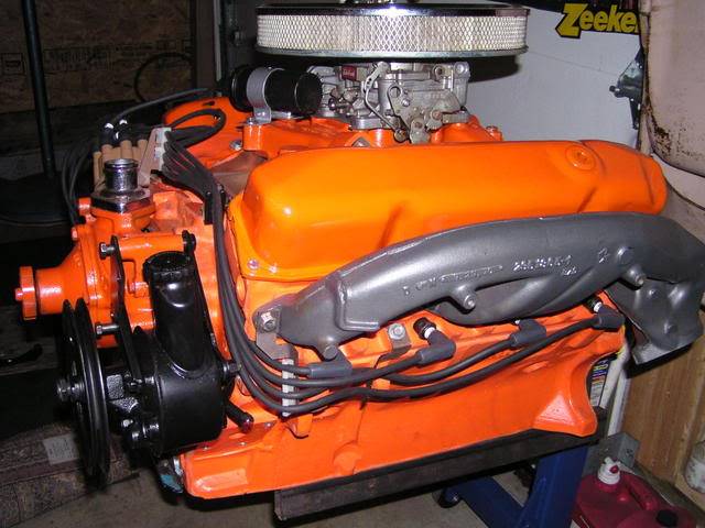

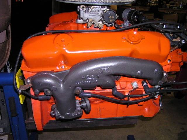

Valve covers are on the wrong sides. THe one with the oil fill cap should be on the driver side. The one with just a small hole and a rubber grommet should be on the passenger side with a pcv valve towards the rear. In the pictures below the valve covers are on wrong too.
Here is where to get the proper brackets https://www.yearone.com/Catalog/chr...spark-plug/spark-plug-wire-brackets-oem-style
Here is how they are ran on the driver side.
And the passenger side.

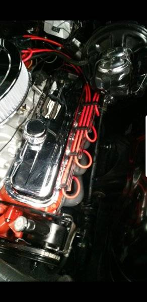

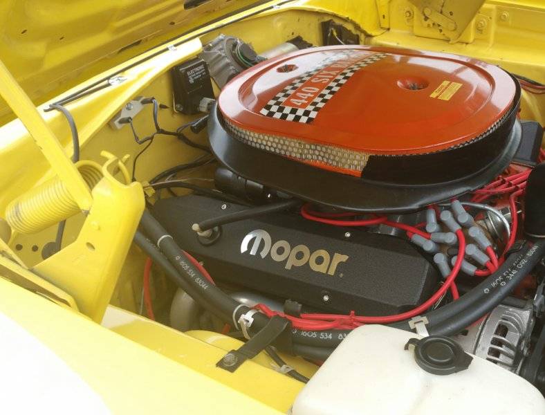

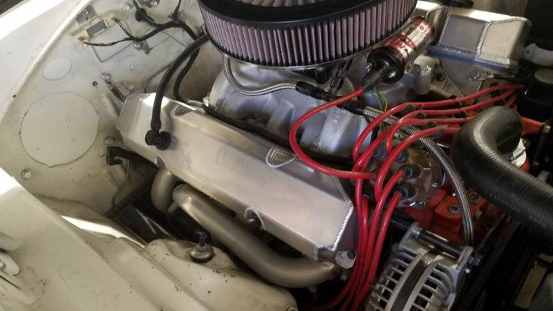

I've been looking at and for a spark plug wire management system for my 440 with TTi headers.
I will post a few pics of some other people's setups and some I may find.
I'm still looking, so post pix, manufacturer's name model # etc please guys!

That is a either a 454 or a 396 Big Block Chevy.. You will not have those choices with Mopar big block plug wire routing. Since MAPAR decided to have the plugs under the damn exhaust ports you are limited to going under your headers.
Be warned.. Put some sort of heat socks on 6 and 7 plugs or you will be replacing wires left and right. Boots are too close to headers and melt or heat crack.
EDIT: Not exactly under the exhaust ports but in a pain in the *** spot none the less.. Too close to the exhaust port.
I like that one clean and simple!
