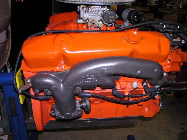

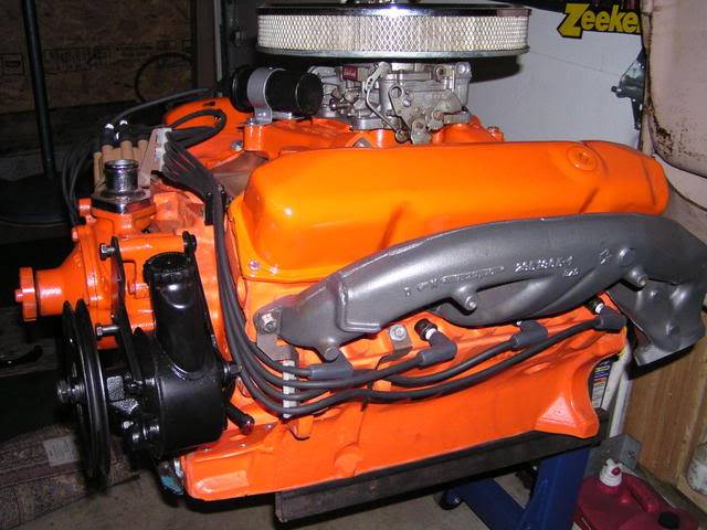

Valve covers are on the wrong sides. THe one with the oil fill cap should be on the driver side. The one with just a small hole and a rubber grommet should be on the passenger side with a pcv valve towards the rear. In the pictures below the valve covers are on wrong too.

Here is how they are ran on the driver side.
And the passenger side.
Kooshs valve covers aren't on the wrong sides. And neither are the ones in the picture you provided. Some engines had the oil fill cap on the left and others had it on the right , but it was always toward the front of the engine.
Well I stand corrected.. Only ones I have ever seen were with the PCV on the passenger side. I supposed anything is possible.

I'm certainly no valve cover expert. I only know what my own engines look like. From doing a Google image search, it looks like 1970 was the year that the oil fill cap and breather cap moved to the pass side and the pcv went to the drivers side.
Yes It seems they swapped 70 up I guess I was always googling 69 or older.
