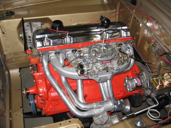

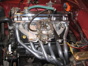

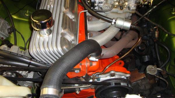

Some say the position of the carb makes a difference.In theory it makes sense. I found no difference (see photos)
Remember this is not a V8 and not all things work the same with the Slant.I have ,along with other racers that Slants don't seem to like allot of timing.Most find that 30* total to be the max.We exclude the vacuum advance for the track.For me 23* total ran the best. Yours may vary. Just a few thoughts. Have fun !
