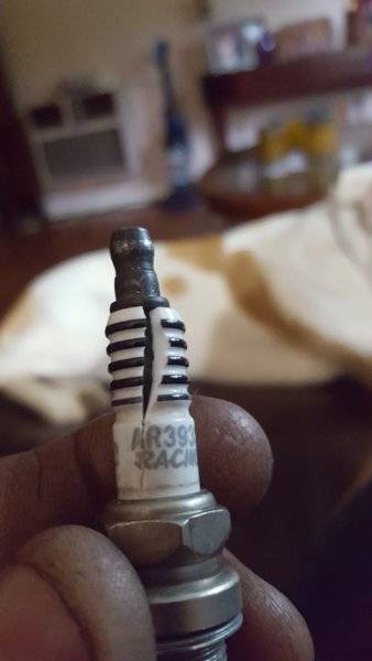

So what does this tell you?
All valid answers though incorrect.
My guess would be that I smashed it with my header during install.
I've been chasing a little hiccup since the install and hope this was it.
I would have thought to much wrench
I was thinking socket not on all the way and slipped off the hex.

I use Autolites and Champions. Plug above looks like the plug socket used to install or remove was missing its inner rubber sleeve. Good way to break plug insulators.
I have seen a few crack when tightening if not real careful as it happened to me before. Good luck as I hope you are right and its ok now. Ron

I didn't feel like taking an hour out of my life to install this one plug after the headers were installed.
So....
That one plug went in before the headers and voila,
Another lesson learned.
My mysterious hiccup has disappeared.
The car ran great yesterday.
