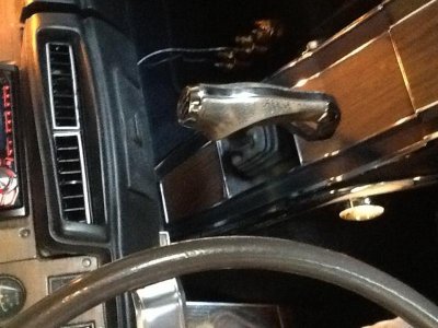

I need to find a better solution on shifter. This one works but It's to far forward and to the passenger side. It could be improved.

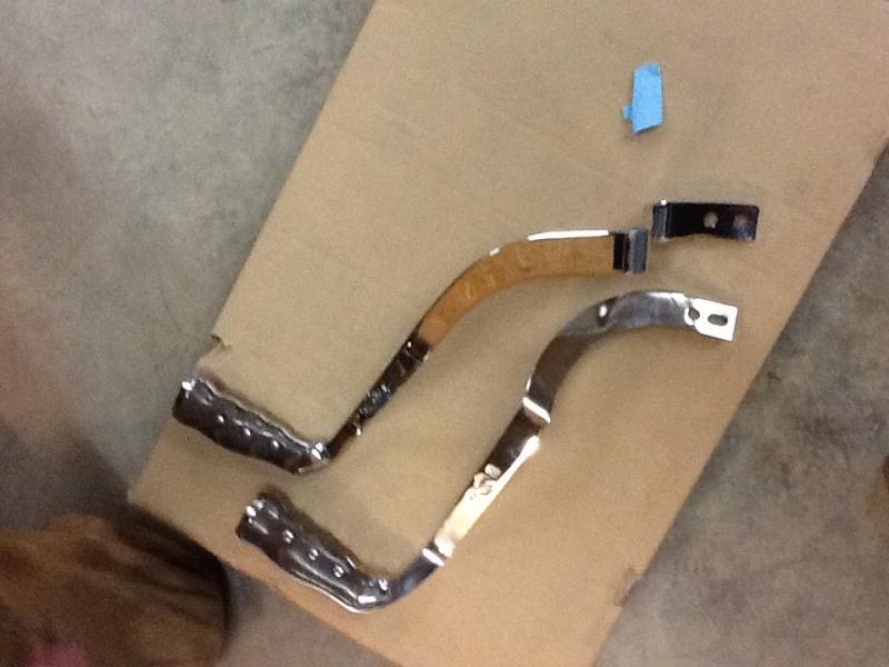

I received the shifter handle from SST. I took a lot of pics to compare. I also ran into more issues to resolve. Check it out-
Shifter Handle Revisited-

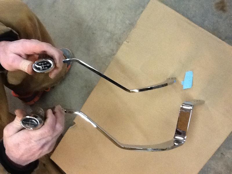

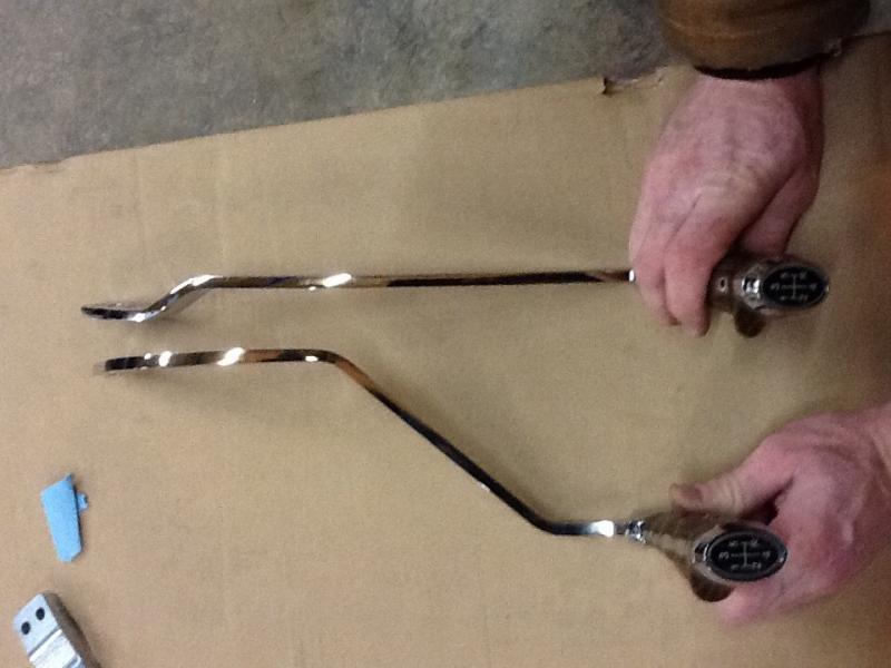

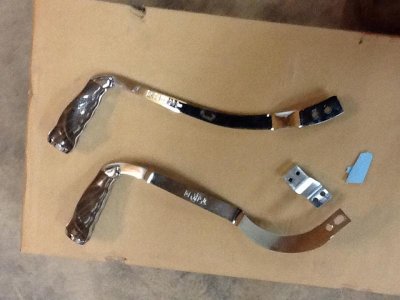

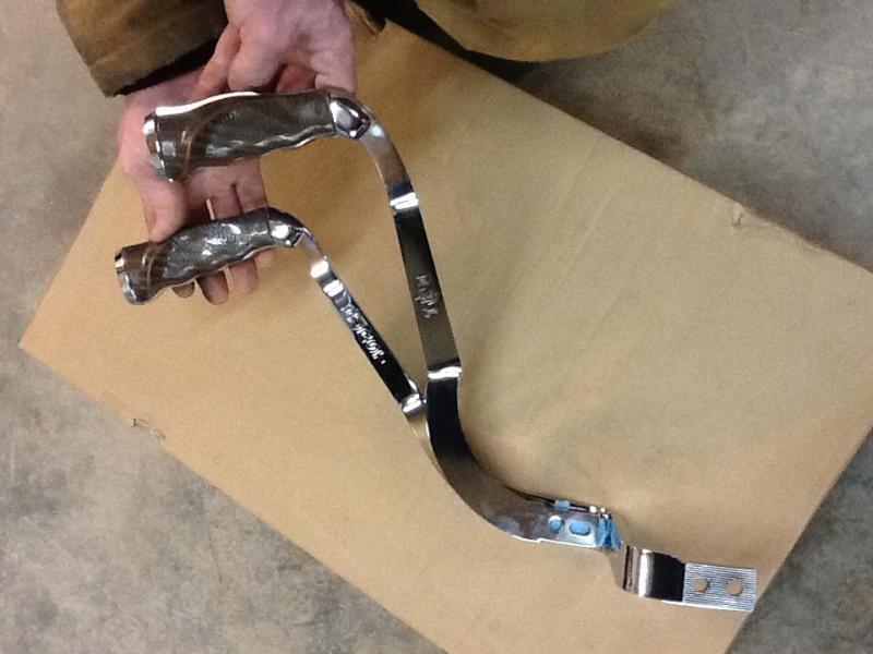

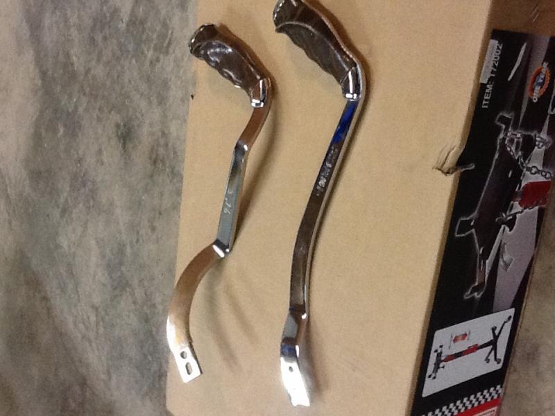

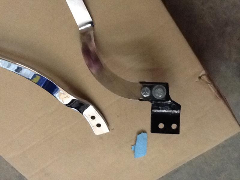

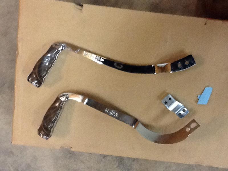

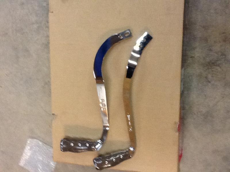

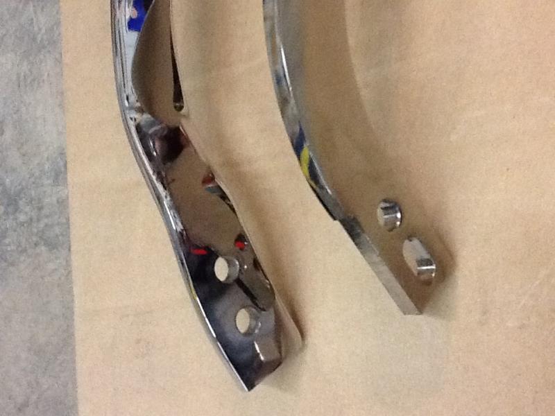

The shifter has proved to be a real challenge. Seems that there are a few handles made for different applications but in my case its not just a bolt it on fix.SST had a special adaptor but It didn't bolt up to my transmission. I even made an adaptor and cut down a nonconsole handle. It did work but I had to reach forward in 1st 3rd 5th. So that brings us up to today.

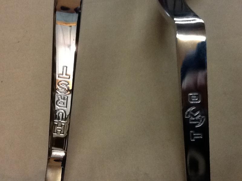

I recieved from SST there TKO Pistol grip for B Bodies.I compared it to my nonconsole cut handle. I assumed the Hurst nonconsole handle and the SST were the same (not at all)both cost $245.I wasn't far off but 4th pic shows how it bends toward driver.

Pistol grip Compare-
You 're Right Hyrdgoon it does.
But wait there is more-

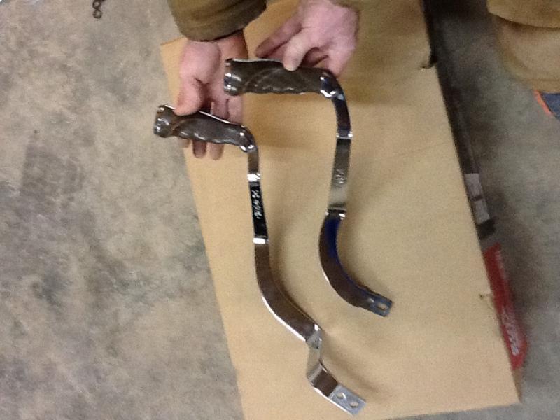

While looking at this TKO handle,I compared it to the 70 console handle. The bend toward the driver is the same. Still not the same angle. The hurst would work if I cut it off and drilled holes. It costs $410 for hurst and the TKO was $245.See pics

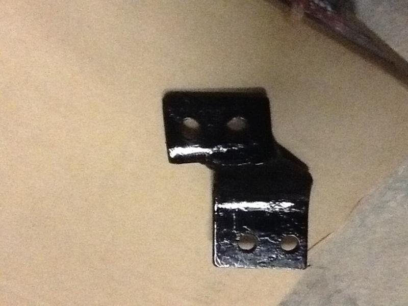

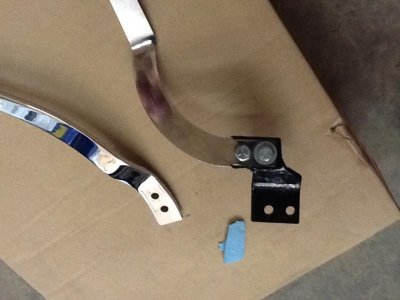

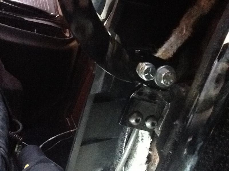

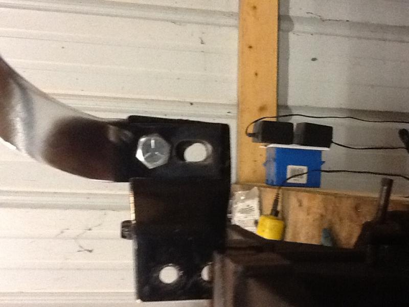

Ok I have the New TKO shifter handle .The adaptor ($79) SST sells with the handle for console apps. It won't bolt to my trans. I have a homemade adaptor that I used with the cut nonconsole handle.
I bolted the new Handle to my homemade adaptor. Guess what- DOESN'T WORK!
When I pull back to second gear the handle bottoms out on top of console.OMG! It's not even close.
So I made a new adaptor.see pics
The adaptor was to offset from where trans pops through tunnel to center of console. Now it also will bring handle up an inch. The mounting holes for handle will tilt it forward toward dash more. Hope that it's enough to get handle off the console in second gear.

More pics
Adaptor

Got it mounted up and put console back in.
The handle is fitting better now.
Instead of reaching out for handle its right there man. It does not even get near the dash panel when it's in 1st,3rd or 5th.Its high enough to not touch the console in 2nd ,4th & rev.Im happy as hell with the way it sits.:rolling:
But dam there is a new issue. It won't stay in 1st or 3rd or 5th when driving. Keeps popping out of gear. Maybe the console boot is tight,I bolted console down. Its like the weight of the handle is enough to pull back/down on the stick from the 1st 3rd 5th gears.Its so ez to shift it falls out of gear No sheet it's crazy!
I'm going to play around with console and boot.
Turns out The console is the culprit here.I moved console forward about 1 1/4 inches and secured it.this relieved the pressure on the boot and shifter.I Then drove around.Shifts are perfect. Not jumping out of gear. It's Right on the money.
A little more drive time proved it. This shifter handle is the best fit. The pistol grip is In perfect location. The shifts are smooth and reliable. Not so much of long sweeping shifts like before.
