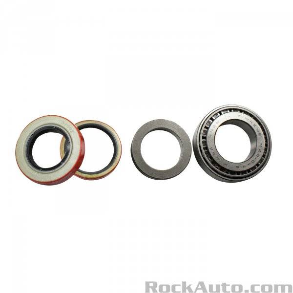

I wouldn't write off the bearings without seeing them. Replace inner seals, re-pack bearings if they still look good and put back together. But the bearing (bearing and race), seals and retainer are listed on Rockauto as PN USA10047 and you'll need 2.
