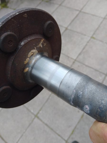

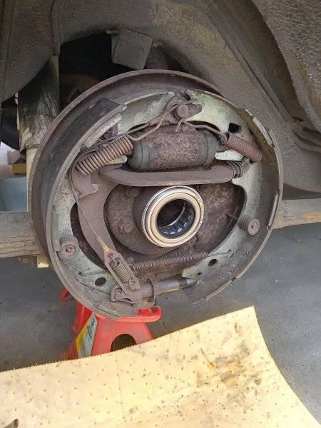

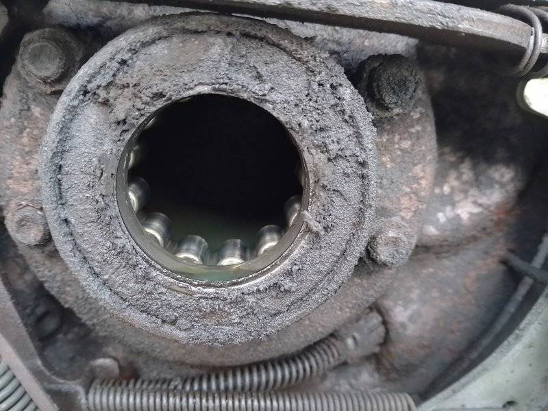

Finally got some time to do the bearings today. It wasn't that difficult, but I have to do everything on my driveway, without a bridge, so that makes it a bit of a challenge.

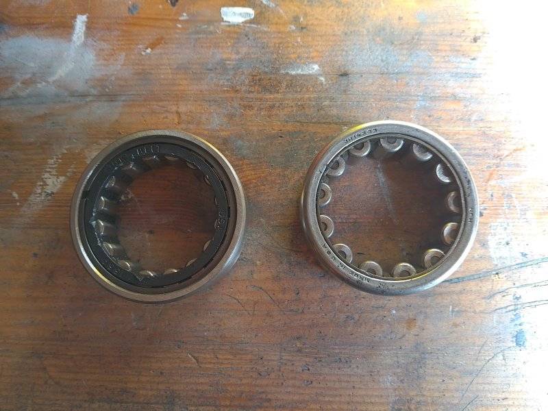

I found out that the right bearing was still the original (and made a scraping noise) and had been leaking, and the left one had been replaced once.
I did install those repair bearings because I was expecting the worse, but the axles looked in perfect shape.
So I hope I can finally drive the thing within a few weeks.
The repair bearings stick out a bit, because they use a different part of the axle.
See the difference in the two old bearings. The left one came out with just one punch of the slide hammer.
I installed two new bearings of course.
