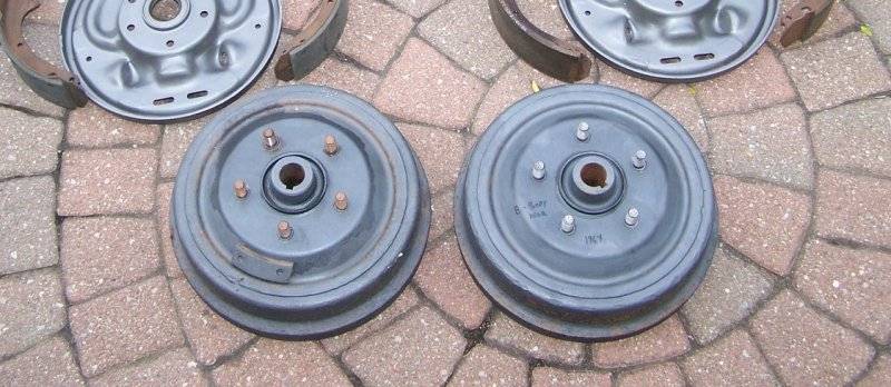

Do the conversion so you end up with removable drums( not permanently swedged together)

If the goal is to just use newer style drums, just do that.. i don't know why everyone is telling you to change out the entire axle.. Convert the flanges to use normal studs/later drums.. takes bout a hour. I did mine, hardest part was finding the proper studs...
Not my post but it shows how...
P.S. i didn't use a drill/hole saw like his... since i wasn't going to use the old drums i just cut the studs off at the drum face with a deathwheel then drilled/hammered the old studs out of the flanges.
