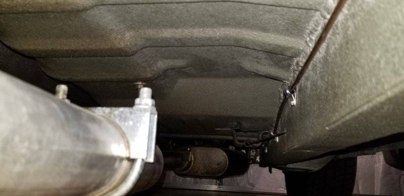

Installed frame connectors and torque boxes on a 70 RR and now has come time to put the rear brake line on. As near as I can tell, it is supposed to go up over the torque box and then pass through a difficult spot through the frame connector. It was a painful process and has resulted in the brake line being twisted many different ways and has lost the factory shape. I'm actually considering taking it back out and running SS braided line so it will flex into all of the non factory spots and look half normal. Has anyone else had any experience with doing this? Thanks in advance.

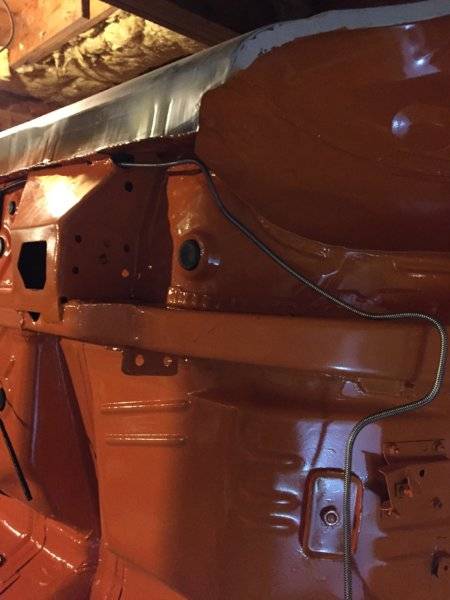

Another issue with the factory style line is it is spiral wrapped and all one piece. Had to wrap the whole thing in electrical tape just to get it through. It took 2 of us about 2 hours to wrestle the line in place and now it looks like crap.... not to mention the small chips of fresh paint that we knocked off in the process :mad:

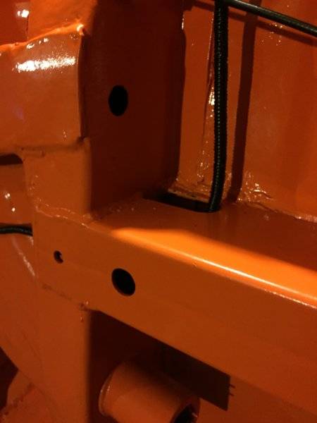

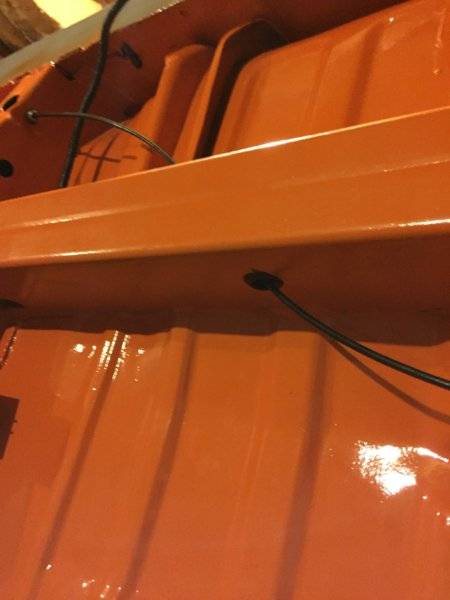

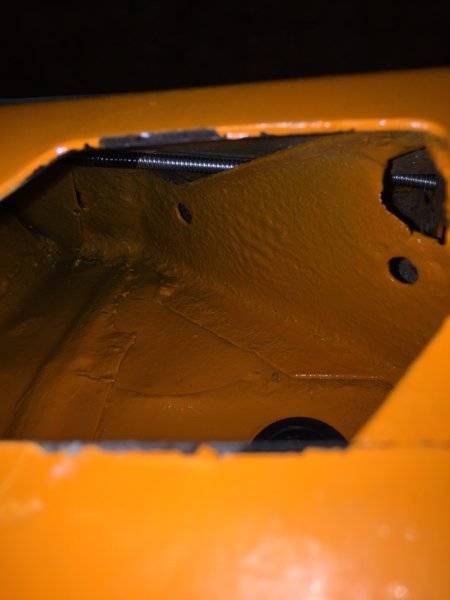

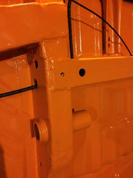

Going in the torque box....
Jeez that must’ve been fun with pre bent lines, if it’s where it needs to be now I’d leave it and add some sleeves/grommets where your entry and exit points are.

Something just looks wrong with to torque box routing. If I remember will post the factory route.
It was a huge pita! That’s probably what we will end up doing. Unfortunately the pre bent line is not so pre bent now lol

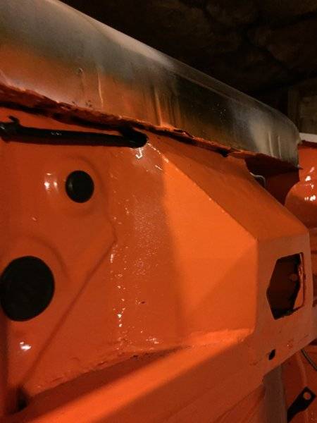

That would be great. We originally had the line on the outside of the torque box but would almost be noticeable looking at the car from the side. Plus the torque boxes have that opening so we just assumed the line went through it.

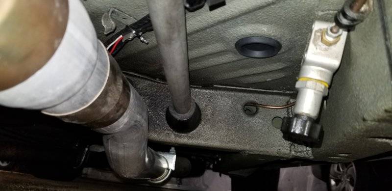

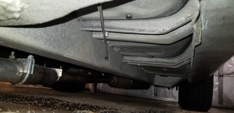

Here's what I did with my ebrake and brake lines. Subframe connectors and also torque boxes.
