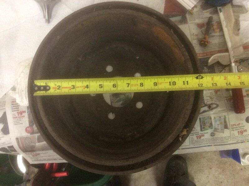

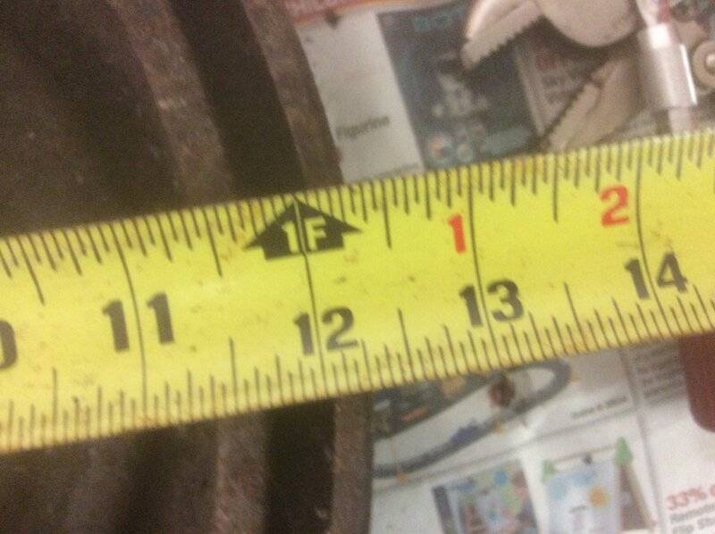

Picture of an 11" drum with the measurement where lip of backing plate runs in groove. 11 7/8"s Make a U in the center a piece of 15" long cardboard to fit around axle to get an exact measurement of diameter of bp.
