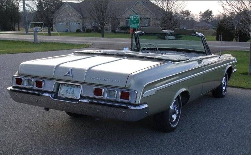

I thought I had seen that thread before! Thanks for chiming in! 64 Sport Fury convertible here. Guess the hunt is on for NOS.
Those don’t look anything like mine.

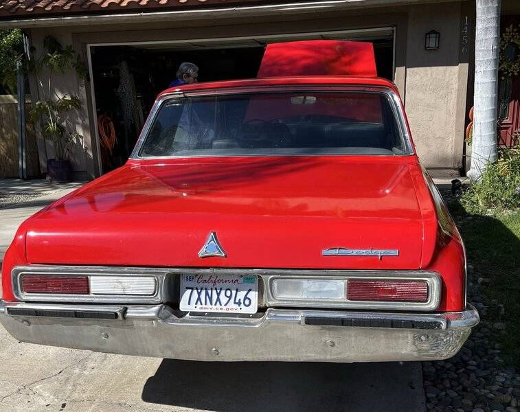

Thanks. It’s bent and I wasn’t sure if it’s the right one. I need to have it repaired.

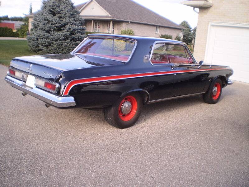

Here is a picture of a friend's 1963 Dodge. I think the rear bumper is different than yours.
Your rear bumper and bumperettes look the same as ones on a 1964 Polara 500 I used to have.
