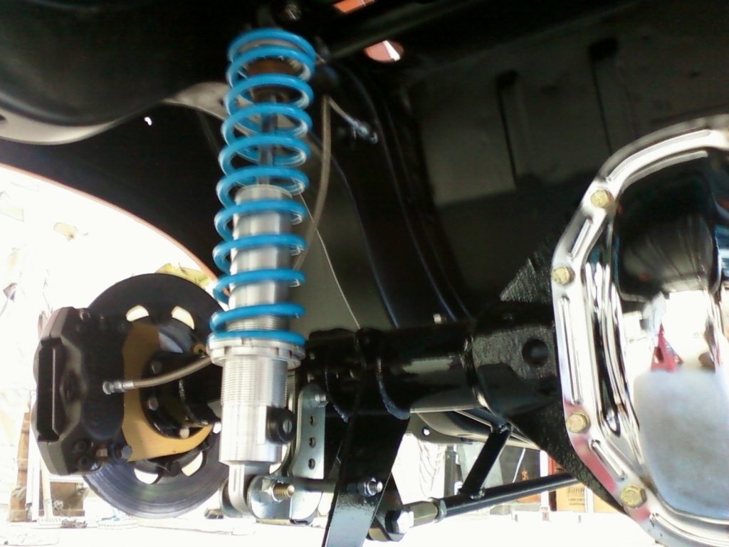

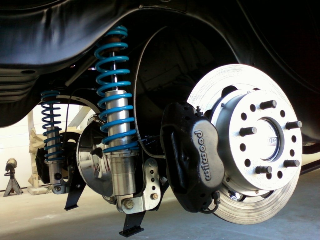

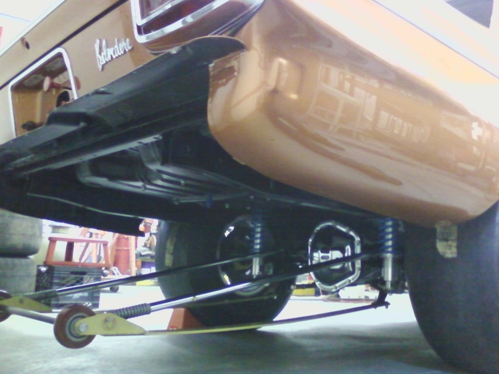

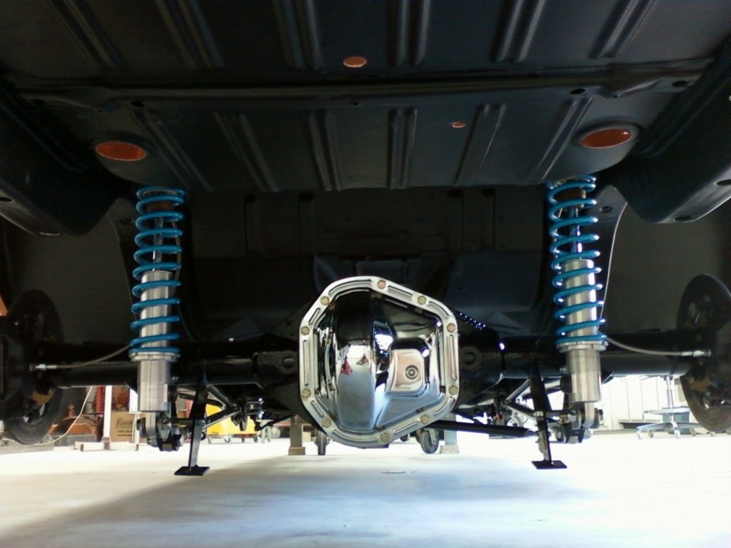

DVW, do you have a picture of your rearend?
Here you go
DVW, thanks, Do you have one from directly from the back with all 4 wheels on the ground? I want to see how much piston you have exposed. Thanks
