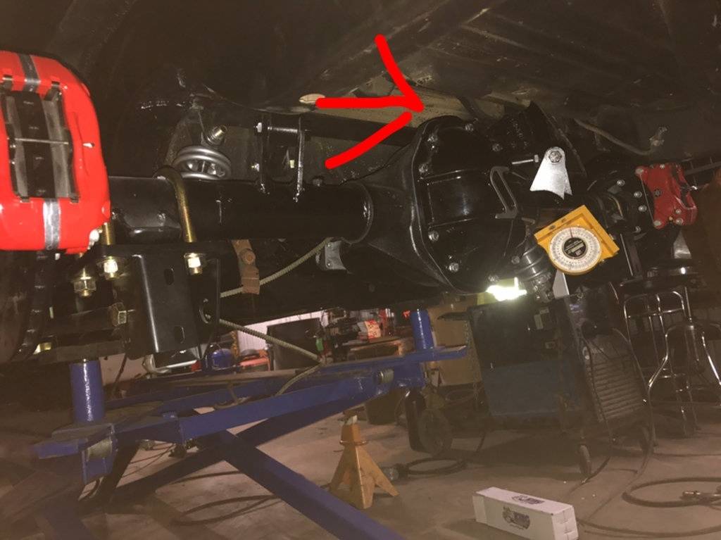

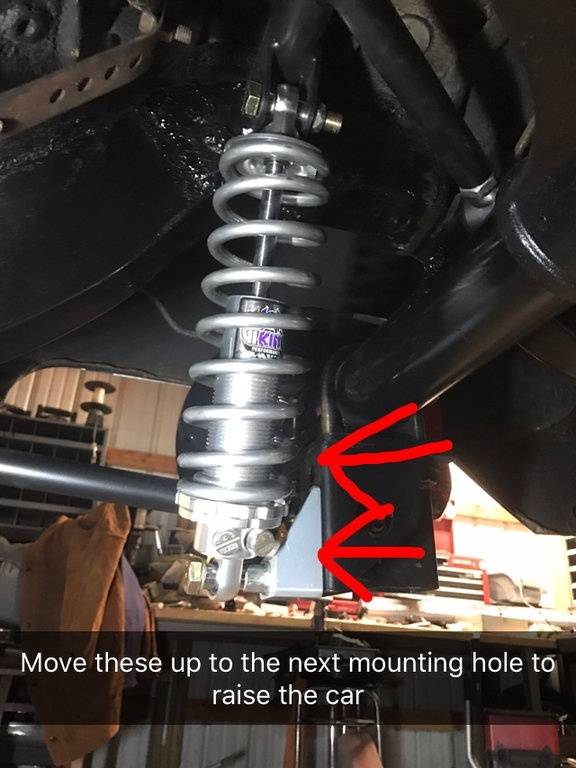

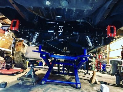

Got my 4 link installed, all is well except it seems the rear end is sitting real deep in the car, car would ride very low. I had to use a spring compressor to get the coils on the shock with the shock fully extended which I assumed was normal since the instructions said that might be necessary. I have them mounted up and they're fully extended so the only way to raise the ride height would be to move the shocks up to the next mounting location correct? I'll call bill at RMS and see if this is normal ride height or maybe he sent me the lowered shocks instead of factory ride height. Also once the weight of the car is on the suspension will I be able to move the spring seat up to raise the ride height?

Yes, move them up one hole at a time till you like the ride height.
