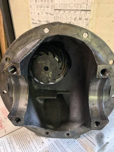

here is a pic of the pinion that still has the factory markings. Think it says -1 and .34. I remember a while back seeing a video on what the markings meant. I think it was in one on the old Chrysler tech videos from maybe 69-71.
