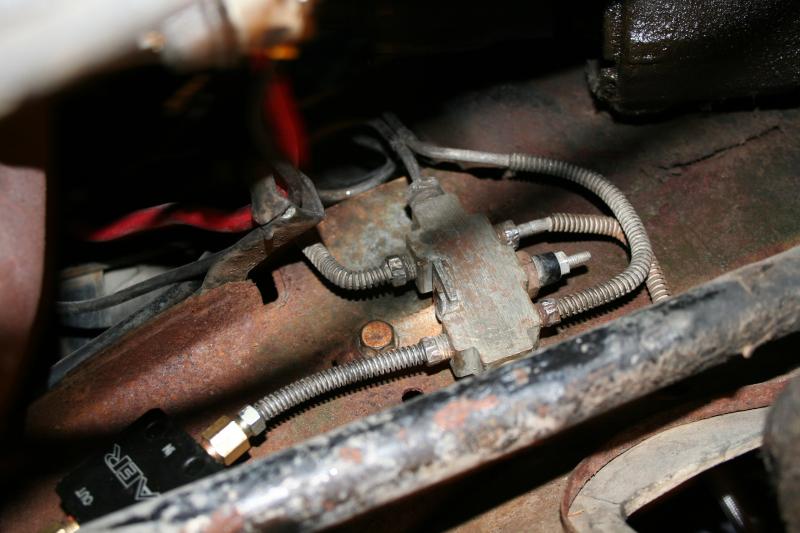

Does the stock proportioning valve stay with the addition of the adjustable valve or does it get removed. Anyone with pics?

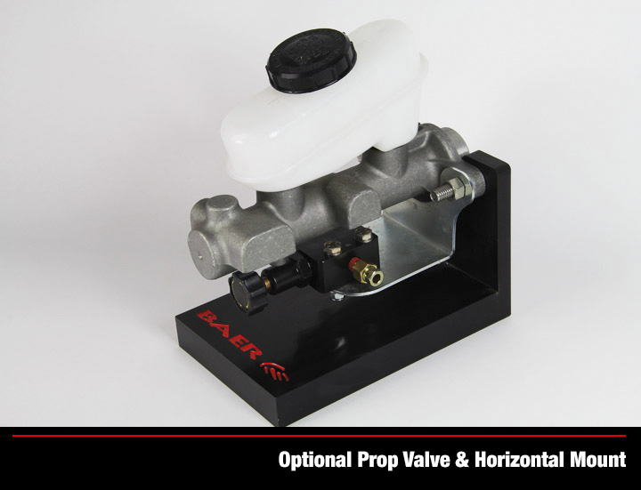

Yes, you'll need to install it on the rear line only, here's mine mocked up, this will not stay here. IMG_0417.jpgThis is how I will be installing it.propvalvehorizontal-01-01-07.jpg
