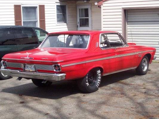

I run the Hoosier radial slicks that are 30 X 9. I drive on the street with them also. I have 4.30 gears and I drive it the 90 miles to Carlisle doing 60 mph on the freeway. It turns about 3200 rpm at 60 mph which is humming right along for it. Ron

Ron thanks for the pics. That car looks amazing!
