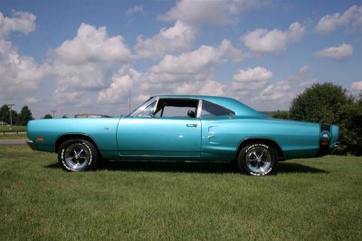

I want to get the car sitting a little higher in the back. Not sure what spinrgs are in there now. attached is a profile of the car..looks a little low in the rear.........Any suggestions?? I was looking at the Mopar performance heavy duty springs made for 440/6 and Hemis.....

Is it just me or does it look higher in the front????
I agree. Back seems ok, front seems a tad high.

I don't think the Mopar XHD springs will change the height any at all. It looks nice the way it is, but I'm a product of the 70's and like to see a little rake as well. Many of the high arch springs being sold are made by Stanley. It's easy to spot them because the leaf ends are blunt cut, not tapered like the factory springs. This probably doesn't hurt anything but they do look different. I think they offer them in +1 and +2.5
I think 2.5 might be too much....Maybe an inch might help.
SHACKLES.......( i know ..i know)....39 buxx....ebay....half hour install... got em on both my mopars... NO ISSUES.... if you like the 70's look....shackles are for you!

It sits a tad high in the rear now. I judge by the bottom edge of the rocker panel. According to that, it's high in the rear. Of course, you gave a picture of the car sitting on grass to go along with a question on suspension. Probably not the best idea in the world.
I think it's dead nuts perfect, btw.
You're right about the grass, but it was the only pic I had of the side like that. I will take a new one in the street tomorrow.
