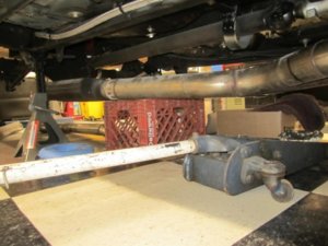

Have to dig through pictures,but I think my car had a leaf link at one time......
I run sliders with 200lbs fiberglass leaf springs (hyperco) and drop front hangers
