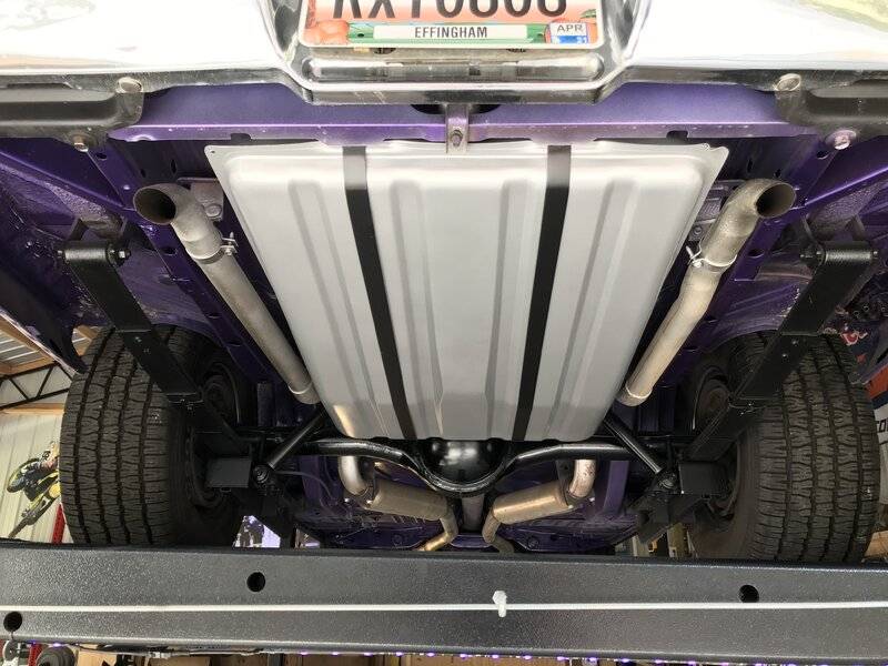

Hey guys! Not sure if you saw our last video where we installed a Yukon 3:73 sure grip center section and green bearings into the Super Bee.
Shameless plug here...
We then took the car out for a cruize and after all the drama we noticed a little vibration. I put the car back on the lift and checked pinion angle. At ride height it was 0. I then checked the driveshaft and the trans tail shaft all read 0. I then recorded the rear axle under acceleration with a GoPro and the pinion angle goes easily to +3. I know there are shims we can put in and I have found the correct length chrome slapper bars (See loves those for some reason) to install.
My question is should there be an arch to the leaf springs? I purchased all new bushings for the leaf springs to change them soon, but after looking at the car on the lift they are almost flat from front to back. All our other leaf spring cars (and trucks) have an arch to the springs, even at ride height....Thoughts?
Depending on the car,age and what not the springs should have a arch.
Flat usually means weak.

something is definitely wrong. you should have an arch. I never used traction bars ever. what springs are in there ? time for new ones. get the proper springs, install a pinion snubber. no traction bars.

They are the stock ones, never touched as my wife is the second owner. I agree we need new ones...Unfortunately she will not budge on the bars (retro hippy chick)

very nice bee. the springs flatten over time. you can get the leaf packs re-arched at a spring and axle shop, the ones that cater to heavy duty freight. or just buy new but those leafs look like in good shape just flat.

Whether the factory springs had a lot of arch or not, the Mopar Chassis Manual mentions that the best handling is achieved with flat springs; they sway less in hard cornering.

Some people just add a leaf at a spring shop.
I've added a leaf before too and have even removed them from Super Stock springs. If the leaf I'm adding is the same length as the one I'm going under, I'll cut off a few inches and round off the corners of it....
