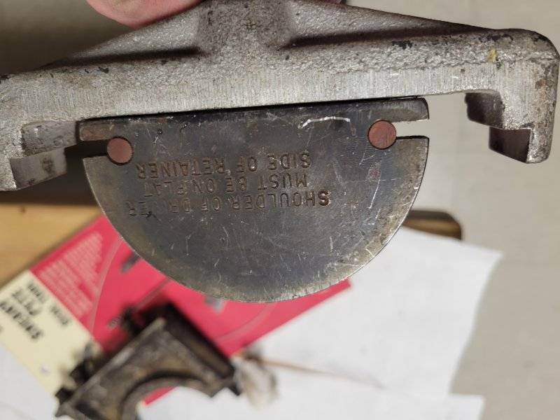

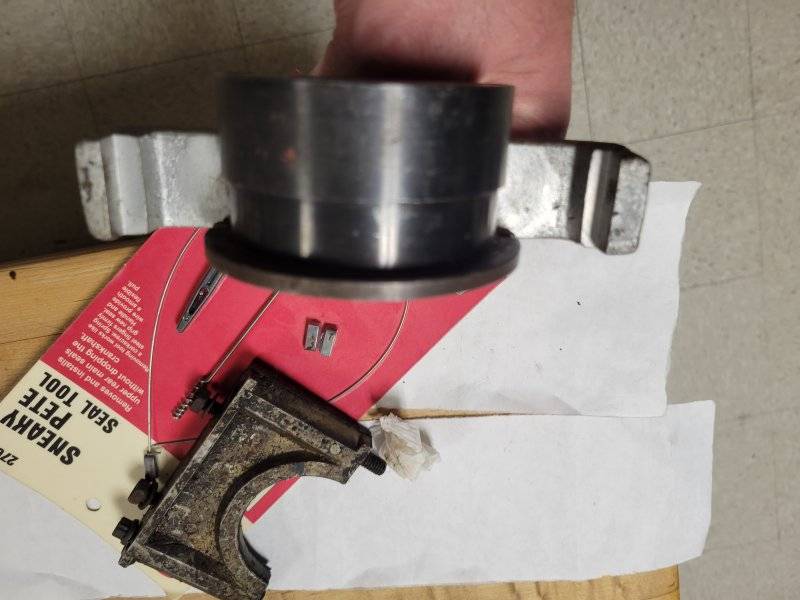

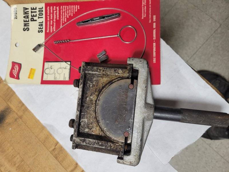

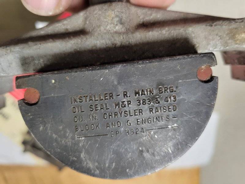

Ok, I am dumb, but what is a: sneaky pete, and a fast fish? Dont have pics do you?

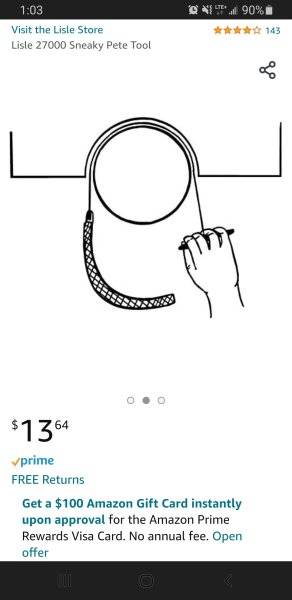

I have one still in the package for when mine needs to be replaced.
That one shown does NOT come in the package. The Chinese finger part is NOT on the end anymore when you order it. It is now a small claw type end which is useless as tits on a bull at least in my use.
