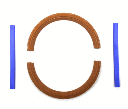

It is also important to "offset" the 2-piece style rear main seals slightly so that the edges don't align directly with the spot where the block & rear main seal retainer come together + add a drop of adhesive to the edges of the seal halves.
Interesting. Have you, or anyone here, installed that type of seal?
I haven't used this seal yet, but I will next time around. For one reason only. The factory style seal won't hold crankcase vacuum. The red seal never leaks when installed correctly.
