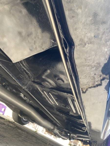

Hi, I have a 69 charger and there does not appear to be any drain holes for any water that gets down through the rear passenger side windows. Is there meant to be and where should I be looking? There are what looks to be an area on the bottom edge of the quarter panel but the holes appear to go no where?

Yes there holes , you have to look where the rocker meets the the floor panel edge . I can send you a photo later .
Thanks photos would be excellent.
i count 3 on my Charger , 2 in front one in back each side of the car . Maybe helps you , but this photo is not from a original survivor car
Do the hole go straight up? I have poked a small screw driver up those holes and they don't seem to go anywhere
They just go to the rocker , if you wash you’re car and specially the side rear. Glass window some water will pass the rubber sealing on the window and runs in you’re quarter panel trough the rocker , and hopefully came out of this hole in the bottom of the rocker
