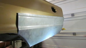

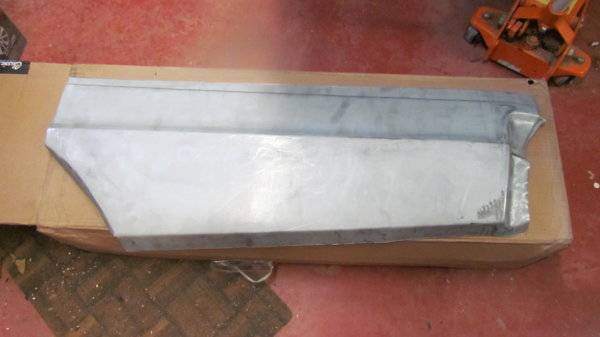

Short report on my quarters. First the are not full quarters. They are for wheel well back to bumper and about half way up. I bought these from Classic Industries.
They are made in the US, reasonably priced (about $110) and most things at Classic are on sale most of the time. I am NOT a body man but they look decent to me. I think they are a step ahead of making the panels from scratch. Right side is MM8216. Left side is MM8215. Fits '67 Coronet R/T but prob fit any '67 Coronet.
Theyll work... yours rusty below the body line?
These are made by Sherman Parts, not the best but it's all that's available. Body lines are softer than OE. I used a LR piece like you have. I had the RR on order but it never showed up so I fabricated that side. I also bought the LS wheel arch but ended up returning that one. I didn't need much so it was better to fabricate in my case. Body lines were poor on the wheel arch.
