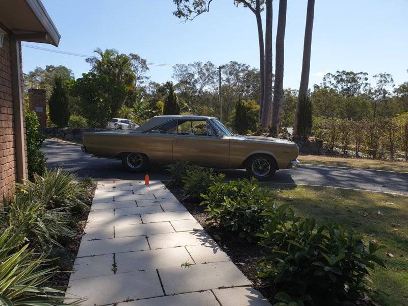

So I got the lower bush sleeve opened up to the correct size for $20 and installed the Konis (not a job a really want to do again - that top nut is a nightmare). I noticed before installation that the konis were about 2" shorter than the original shocks when fully extended, but as the installed length was about 1.5" less than the konis full extension then I thought it wouldn't be an issue....
Now the car sits about an inch lower at the back, and the front has a corresponding increase in height. This is probably close to the factory look but I've always preferred the rear slightly higher than the front, not the other way around.
As the shocks supposedly don't contribute to ride height unless they are maxed out and pulling the car down, could this lowered rear stance be due to the original leaf springs being weak and they were being "assisted" upwardly by the original longer shocks?
The car definitely rides better with the konis, but is slightly more floaty on the front due to new rearward bias - maybe I could leave the rear alone and lower the front a touch by backing off the torsion bars?
I'm also considering painting the original shocks and putting them back on, but that's a backward step really. Any help or ideas appreciated.

Yes looks like the stock ride height. Before lowering the front to much check proper ride height of suspension peices.
I was never fond of the bumper drag look on the 66 either.
Kinda hard to tell the stance on a drive that's not level however, based on where the wheel are in relation to the body, it looks pretty close if not spot to the factory ride height. Can you take a pic of it on a level area?

Maybe I'm just losing my marbles, but the car looks lower at the rear than it did before I started.
I also took measurements this morning from floor to top of fender (wish I'd taken some before I did the work). The front of the car is within 1/2" side to side, but the rear differs by 1 1/2" side to side, and they are crossed on the diagonal, so the passenger side is slightly higher at the front and lower at the rear, and the drivers side is slightly lower at the front but higher at the rear, so the whole car is twisted slightly.
