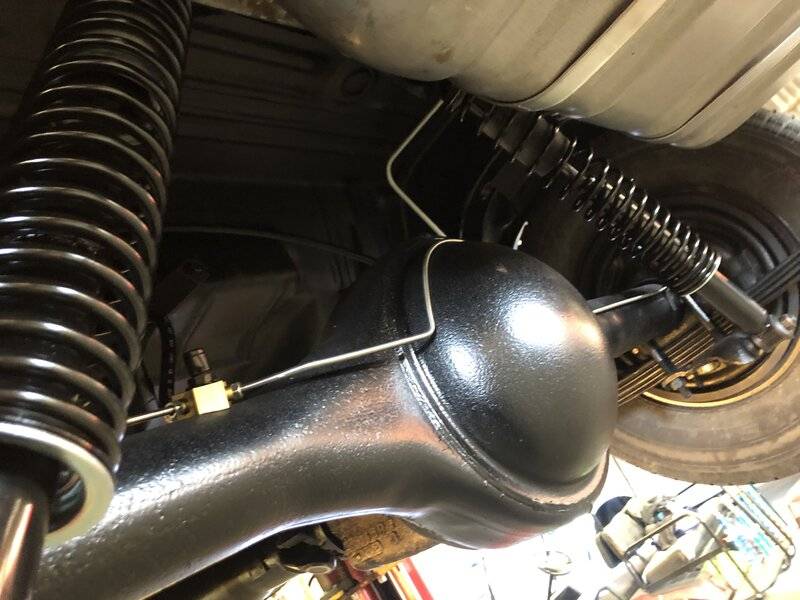

Has anyone installed the KYB or equal mono tube type shocks in the front or rear of the car?
