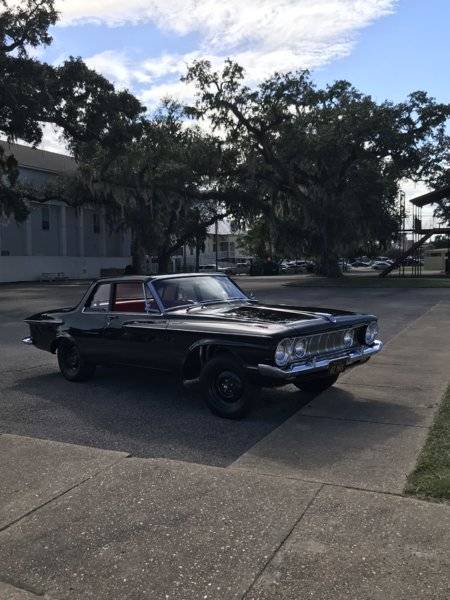

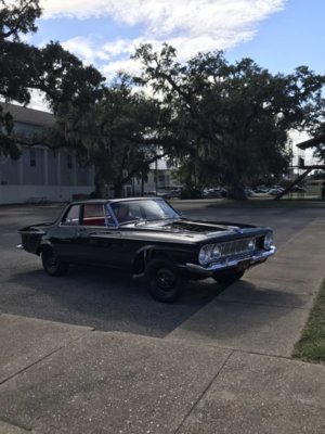

I agree with moparedtn, I too am in the process of doing a 63 Belvedere old school stance. Looking at the black 62 in your avitar I don't see how that is done with factory suspension. I am running 29'' rear tires with Eaton Detroit Springs rear springs with a 2'' drop and 100lbs increase for weight. My T bars are wound up and the upper control arms are at the limit with with the bump stops removed.Ive left about 3/8'' travel for the control arms to have some movement. Front tires are pie cutters 165/80/15.
The darn thing sits dang near level. :BangHead: I will be playing with the camber/caster settings to even out the wheels. Right now they are negative 3/8* planning on setting them to 0*. Don't have any photos but :mad:Not happy with results....Once I get it on the road I'll be looking at getting some taller front tires.
Try some 16” studabaker rims in the fronts. Old school trick.
