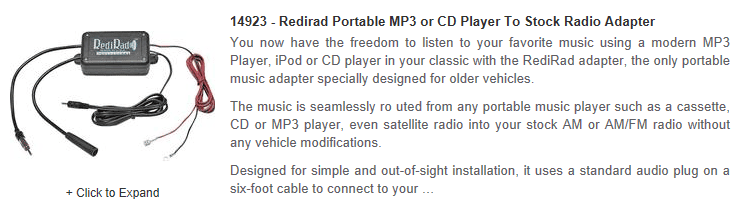

This might be a good alternative as well. http://rediscoveradio.com/

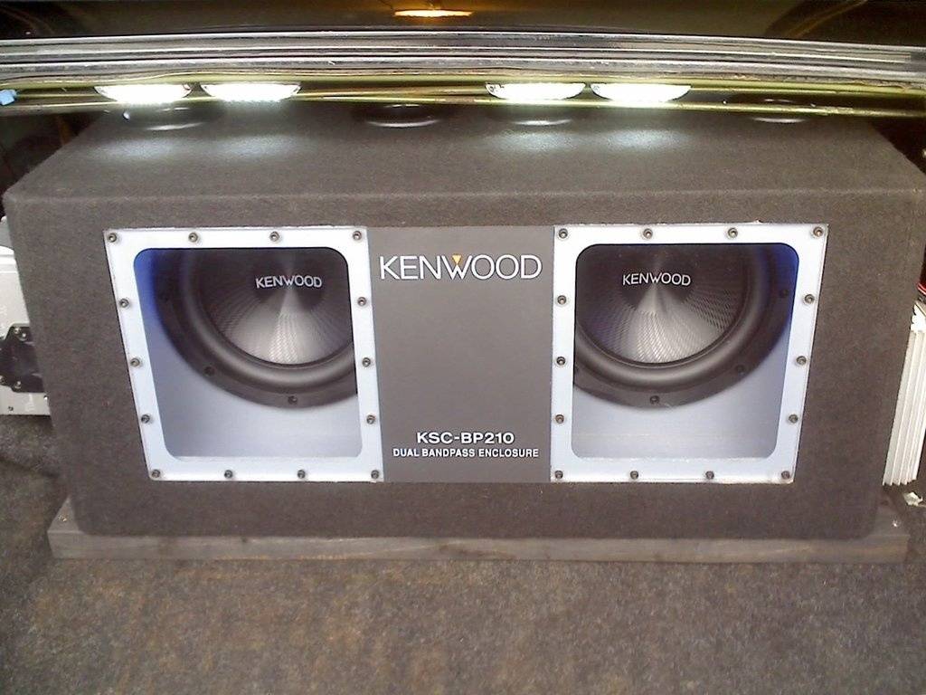

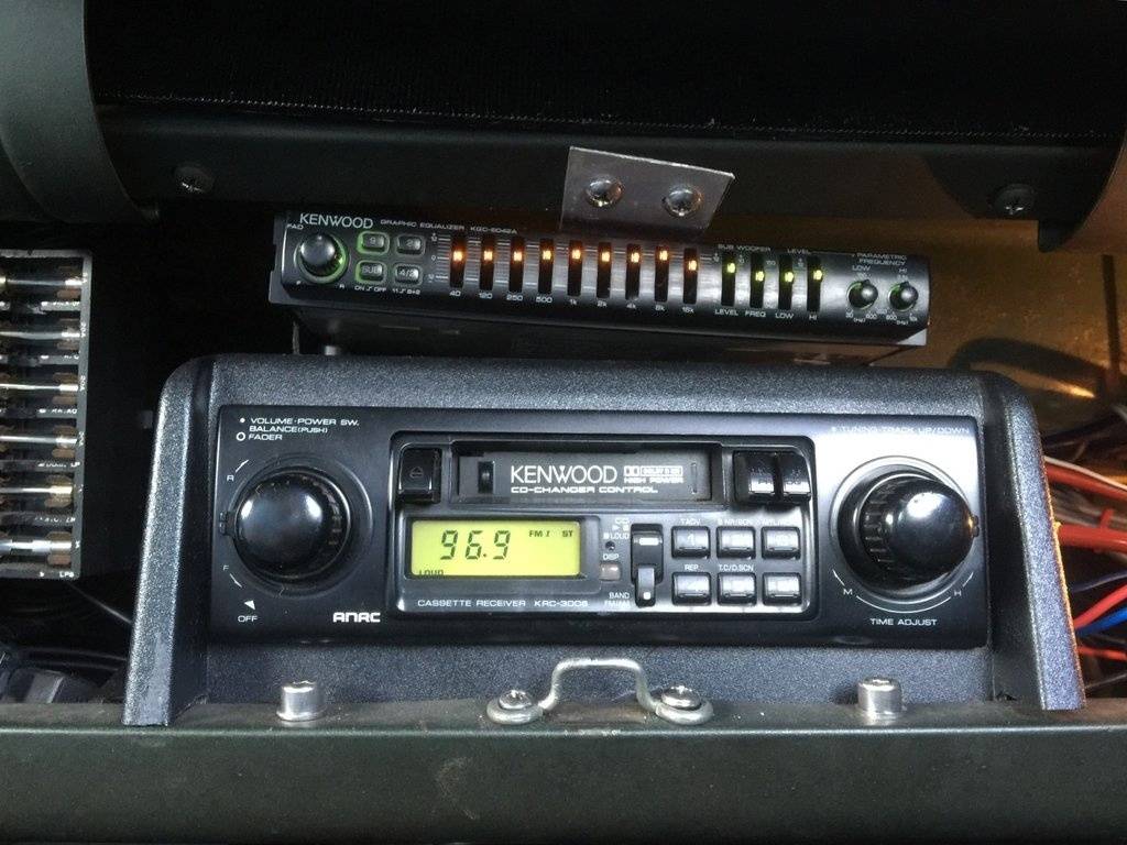

I have similar setup as others have said. I have a Bluetooth receiver adapter (phone is wireless to the Bluetooth), like this:
https://www.crutchfield.com/p_822BTREC/Milennia-MIL-BTREC.html
The adapter is plugged into a preamp/EQ (hidden behind glovebox door), that splits the signal into front, rear and subwoofer channels. I have 3 amps in the trunk (mounted 2 on the rear, 1 on the side of my Sub box). My system BOOMS!, but you could do similar, w/ a single amp and a Bluetooth adapter. I don't even think you'd need the preamp?

So played around with the speaker and not loving it, so leaning to going with the Rediscover Radio adapter, so need some advise. I'm guessing I can wire rear speakers to the front speaker wires so I'd have 3 speakers working in the car.
Based on this listing from Tommy @ Parts Hound, looks like I have to get original type speakers if I'm using my original unit. Just wondering if anyone has just bought regular speakers & if you had any issues.

In my Belvedere I went with the redi rad and no regrets. Just running the single stock speaker in the dash and its loud enough and sounds "right" For the price I couldn't be happier. The car is so noisy that I think a high end stereo would be sort of a waste. I've thought about adding a rear speaker as the car was built for one but the wiring was hacked off the fade control. For speakers that work with your stock radio look here: http://www.turnswitch.com/speakers.htm
