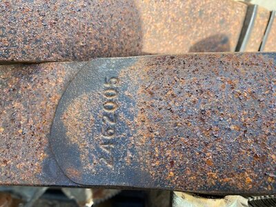

Hello
I picked up a bunch of parts along with my 67 Belv. The car was beong set up for a hemi conversion. I have the Hemi conversion mounts 8cy K member. at one point a 383 was installed in the car. My question is how do I identify hemi rear springs and do they differ from stock springs used on other 8 cyl cars. The set of springs on the car appear different than the 2nd set that were also included. I attached a picture for reference. Thanks.
by the number of springs, and the part number you see on yours.that part number is matched to the 318 auto, but the 383 two barrel I believe had the same springs. four and five a side?
I don't have the part numbers, but they are the 7 leaf, 6 leaf arrangement as the 440 and Hemi equipped cars were. They are different than the 68-70 springs on 440 & Hemi cars. Exact differences I don't know.
