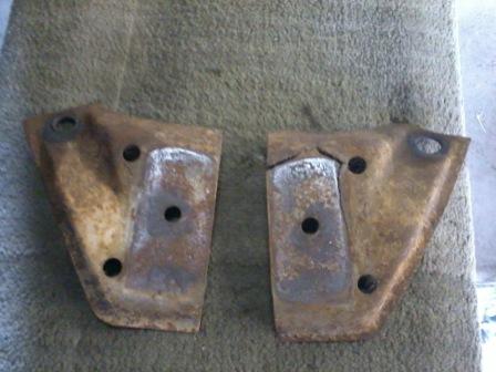

I’m in desperate need of a 1972 charger right rear sway bar bracket/plate. It’s the bracket/plate that mounts between the leaf spring and shock plate. I will buy the pair or complete sway bar set up if I need to. Thanks

Hey Bill, anybody decent enough with a welder could fix the one you have. A little grinding and probably better than new because they all break there if abused. Get them to weld up the bushing hole and drill it out to renew it while they are at it. Once the bushing is there nobody will notice the missing ring. People bring in stuff to the body shop where I work and we do it for cash and a break from the everyday BS all the time. Just an idea for a hard to find item.

I was going to do that, but it's also bent a little. I’m going to buy a complete set up from Tony’s parts. Thanks.
