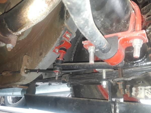

got a aadco 7/8 rear bar and wondering if anyone has installed one in their 64 or 65,any problems , pics please.thanks.

thanks,I will keep that in mind .I've got the 1 1/8 front bar on its way. hard to wrap around the strut mounts and their length on the rear.
No issues . Got same on my 64 440. Front was not a bolt on, required drilling. Makes a huge difference in the car. If you have not done a front end kit , now is the time.
