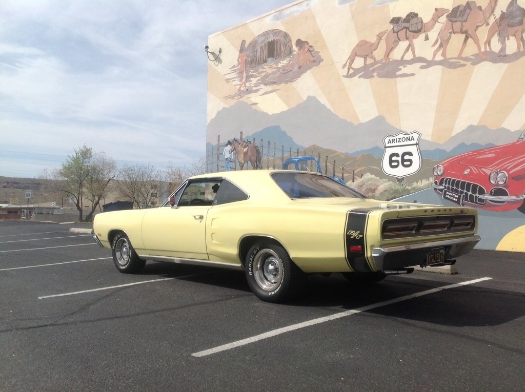

Hi guys! been a while since i posted here , I just got back from the carlisle show and got ma wheels turnin. I am just about to this point and I was wondering about rear tire size , as in how wide/high ? I saw some cars with 29x12.5x15 ( i want to go with a 10x15 police wheel) . I would like some input as to wheel tub clearance and spring clearance, offset spring hangers, spring relocation/ minitub kits and outer wheelhouse mods. I would love some input from you guys as most of you have already done this in some way shape or form. I'm just not sure as to weather I want to cut my frame rails, I would like to weigh the other options first. thanks for any and all input , rock on mopar buddies!!!!!
10x15 wheel with a 5" backspace with a 295/50/15
clears just fine on my bee and also a friend of mine has a 69' satellite with this same combo and clears fine.
I'm an L60 guy myself for the 68 GTX. They would fit your RR perfectly and you wouldn't have to cut anything. They give you nice width...
295 50 15. 8" rim. No modification except extra leaf.
